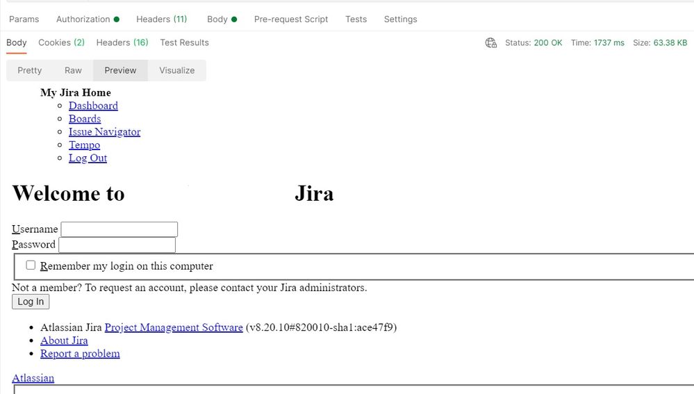

@Andy Heinzer After changing "Type" from basic to bearer now I can get 200 OK but in response getting whole html page source code which cantans lot of hyper links along with login page asking username and password.
Any hints?

Based on the response of the login page, it looks like your authorization is failing. The payload looks like you're trying to do a POST to that endpoint. While you can start there, I tend to suggest trying to do a GET from that endpoint of a known existing issue that your account has access to. This tends to be a bit easier to make sure that you can get back the expected output before trying to create a new issue.
I recommend trying to follow the steps in https://developer.atlassian.com/server/jira/platform/basic-authentication/ to encode your credentials in the base64 string and then pass that encoded string as part of an authorization header. If this is done correctly, you should get back the issue details in a json format.

@Nikola Perisic I am using postman and I am using my mail id and Jira api token
do you think it could be that some restriction at jira is not letting me call api?
I am using Postman as well, and for authorization I am using the Basic Auth. Are you using the same auth type?
I have tried it with my test account and it works but not for my work jira hence curious if there are config which let us block users to connect using api
Understood. I have the rate limiting for API, but this is more blocking the users to use the API at all. I would see what others from community think about this.
