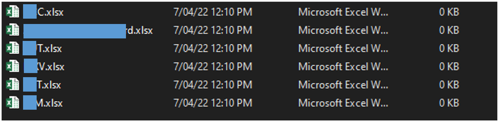

I'm trying to download all attachments from confluence page using the following python code. the downloaded files are 0 kb

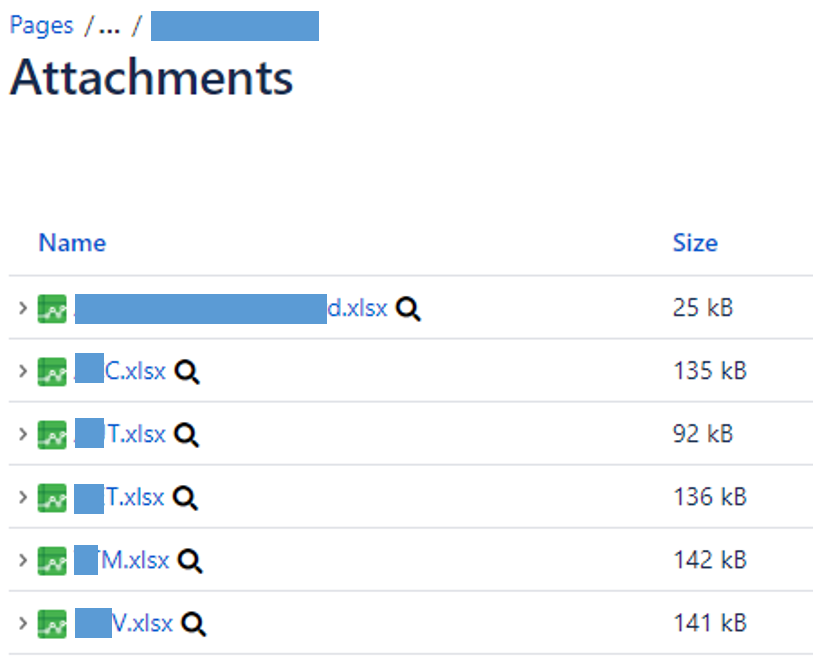

files in the confluence
downloaded files

the code generates a download URL for the attachment. This is the result of printing the download link
the file is downloaded when I put the URL in the browser.
regarding the "Get attachment content", I cannot get the ID of the attachment
Nic Brough -Adaptavist-
July 5, 2022
Ok, so you're using the wrong url - your script is not a browser, so it's not got all the functions you need to use a direct download.
You need to swap to using the REST api.
