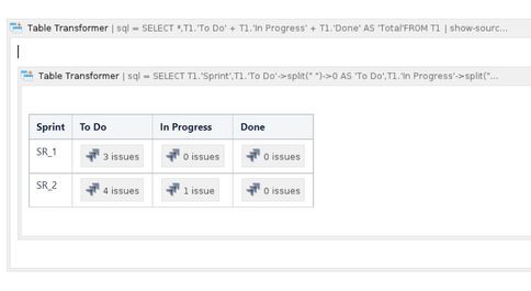

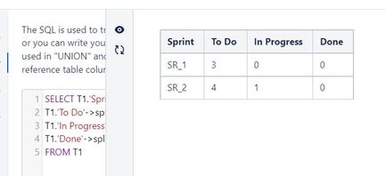

I have a table to track jira task based on their status as below.Capture.JPG
The inner table-transformer is to get the numbers properly for each status column. I use split function to retrieve the numbers.  (eg: T1.'To Do'->split(" ")->0 AS 'To Do')

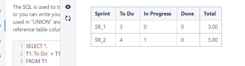

The outer table transformer is to add a total column that sums up each status column. But the output adds decimal points to the total column, i dont know why.
I tried to use ROUND(T1.'To Do' + T1.'In Progress' + T1.'Done' AS 'Total',0) as well, but decimal points still there.  Pls help.

Hi @emagnun ,
Check the settings of your Table Transformers -> Decimal places. You may have "2" there (if earlier you used macros with this precise settings, the current macro may catch it).
emagnun
December 2, 2021
got it... my bad. it was the settings.
So ROUND() can not override if the settings has it 2?
Katerina Kovriga _Stiltsoft_
December 2, 2021
No, and it is always better to leave this field blank if you use ROUND() inside the SQL query.

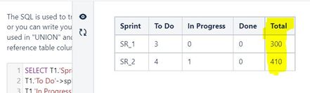

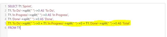

@Katerina Kovriga _Stiltsoft_ I tried to combine two table-transformers into 1 by the adding below yellow query, but it seems to be working as string concatination. How do I get this to work as integer addition?
December 2, 2021
Try this SQL:
SELECT T1.'Sprint',
T1.'To Do'->split(" ")->0 AS 'To Do',
T1.'In Progress'->split(" ")->0 AS 'In Progress',
CAST((T1.'To Do'->split(" ")->0) AS INT) + CAST((T1.'In Progress'->split(" ")->0) AS INT) AS 'Total'
FROM T*
Adjust it to the third "Done" status, I have the two statuses.
Like # people like this
emagnun
December 2, 2021
Worked like a charm. Thanks
