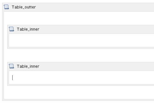

i want to build a dynamic table (with costumizable amound of tablerows). For that I want to nest macros.
the outter macro rn:
<table>
<tr>
<th>header1</th>
<th>header2</th>
</tr>
$body
</table>
the inner macro rn:
<tr>
<td>cell1</td>
<td>cell2</td>
</tr>

My problem is, that the output of nesting the macros is not an table.
The output looks like this
I think the code of the inner macro is rendert wrong sothat the output of the inner macro is:" cell1 cell2 " instead of "<tr><td>cell1</td><td>cell2</td></tr>"
