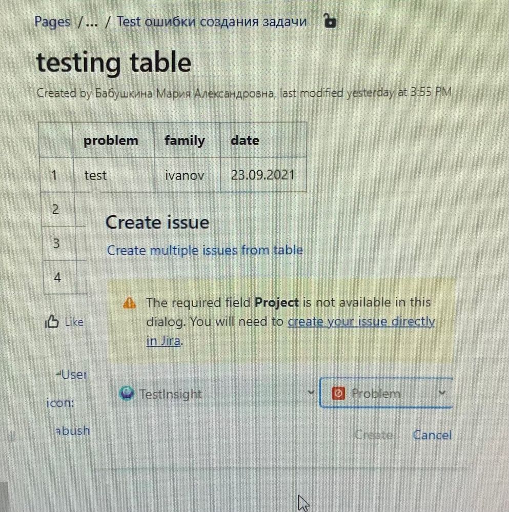

Can anyone tell me how to create a button in confluence when I click on which tasks will be created in Jira?
Jira, I have a server version. Creating tasks through a macro does not work due to an error that we cannot solve for a long time.IMG_8094.jpeg

Hi @Мария,
There's a bug in Confluence that prevents creation of a new issue in Jira if there are required fields: https://jira.atlassian.com/browse/CONFSERVER-41726 As a workaround, set the field Проект optional.
You can also try to create custom buttons with images and direct HTML links (insert images and add links to them) which will not create a Jira issue but will open a Create Screen with prefilled fields. See the instruction here: https://confluence.atlassian.com/jirakb/how-to-create-issues-using-direct-html-links-in-jira-server-159474.html

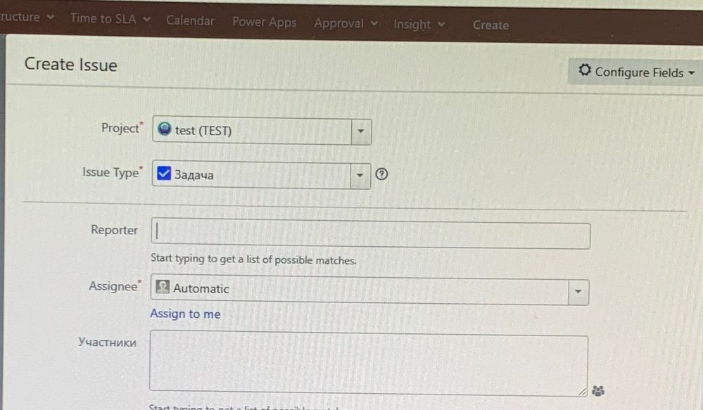

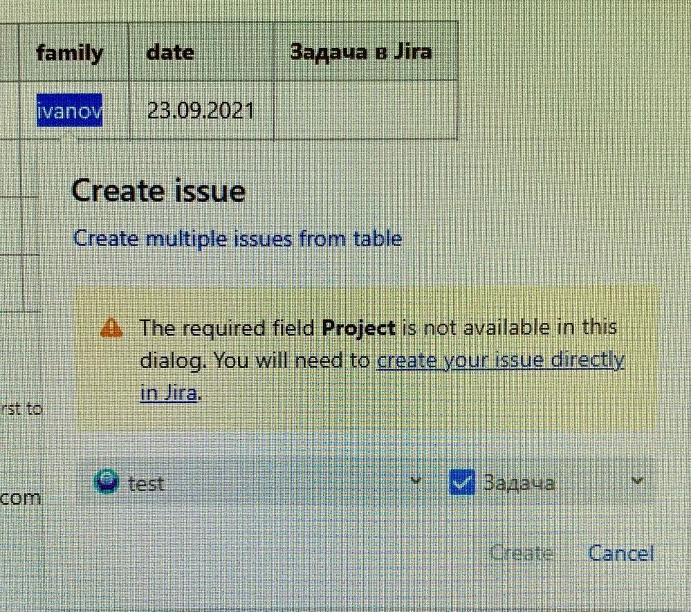

@Kseniia Trushnikova
Yes, I'm sure it's a system field. We don't have a custom "project" field. Here is the same error with the "test" project. And a photo of the fields used when creating a task in this project.

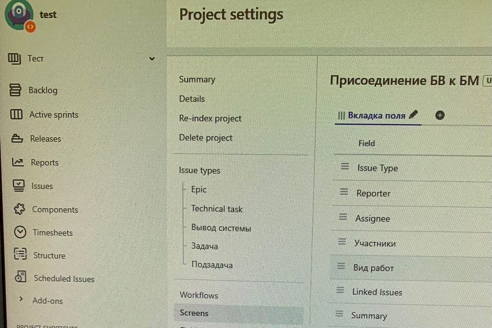

August 1, 2023
@Мария, I see. For some reason I can't reproduce your issue. Can you check the project field configuration scheme and set the field Project optional? Since this field cannot be empty, there is no need to make it required.

Мария
August 1, 2023
I can't find this field in the field configuration diagram.... He's not there.
Kseniia Trushnikova
August 1, 2023
@Мария, sorry, that's my bad. It looks like that is me who has the custom field named Project here. Please ignore my comment above.
giphy
I'd try to recreate an application link between Jira and Confluence and then still I'd recommend you to contact the Atlassian support. Your issue looks tricky.
