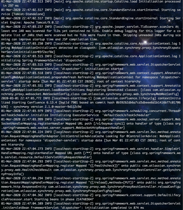

hi, my Confluence application and database are installed in docker. This time migrate Confluence from one server to another. The application reports an error when the application starts. When starting, there are the following errors.
executing as current user
If you encounter issues starting up Confluence, please see the Installation guide at http://confluence.atlassian.com/display/DOC/Confluence+Installation+Guide
Server startup logs are located in /opt/atlassian/confluence/logs/catalina.out
Using Java: /opt/java/openjdk/bin/java
Picked up JAVA_TOOL_OPTIONS:
2020-03-01 14:47:01,282 INFO [main] [atlassian.confluence.bootstrap.SynchronyProxyWatchdog] A Context element for ${confluence.context.path}/synchrony-proxy is found in /opt/atlassian/confluence/conf/server.xml. No further action is required
01-Mar-2020 22:47:02.261 WARNING [main] org.apache.tomcat.util.digester.SetPropertiesRule.begin [SetPropertiesRule]{Server} Setting property 'debug' to '0' did not find a matching property.
01-Mar-2020 22:47:02.295 WARNING [main] org.apache.catalina.startup.SetAllPropertiesRule.begin [SetAllPropertiesRule]{Server/Service/Connector} Setting property 'proxyPort' to '' did not find a matching property.
01-Mar-2020 22:47:02.296 WARNING [main] org.apache.catalina.startup.SetAllPropertiesRule.begin [SetAllPropertiesRule]{Server/Service/Connector} Setting property 'debug' to '0' did not find a matching property.
01-Mar-2020 22:47:02.346 WARNING [main] org.apache.tomcat.util.digester.SetPropertiesRule.begin [SetPropertiesRule]{Server/Service/Engine} Setting property 'debug' to '0' did not find a matching property.
01-Mar-2020 22:47:02.349 WARNING [main] org.apache.tomcat.util.digester.SetPropertiesRule.begin [SetPropertiesRule]{Server/Service/Engine/Host} Setting property 'debug' to '0' did not find a matching property.
01-Mar-2020 22:47:02.370 WARNING [main] org.apache.tomcat.util.digester.SetPropertiesRule.begin [SetPropertiesRule]{Server/Service/Engine/Host/Context} Setting property 'debug' to '0' did not find a matching property.
01-Mar-2020 22:47:02.381 WARNING [main] org.apache.tomcat.util.digester.SetPropertiesRule.begin [SetPropertiesRule]{Server/Service/Engine/Host/Context} Setting property 'debug' to '0' did not find a matching property.
01-Mar-2020 22:47:02.502 INFO [main] org.apache.coyote.AbstractProtocol.init Initializing ProtocolHandler ["http-nio-8090"]
01-Mar-2020 22:47:02.509 INFO [main] org.apache.tomcat.util.net.NioSelectorPool.getSharedSelector Using a shared selector for servlet write/read
01-Mar-2020 22:47:02.513 INFO [main] org.apache.catalina.startup.Catalina.load Initialization processed in 297 ms
01-Mar-2020 22:47:02.517 INFO [main] org.apache.catalina.core.StandardService.startInternal Starting service [Tomcat-Standalone]
01-Mar-2020 22:47:02.517 INFO [main] org.apache.catalina.core.StandardEngine.startInternal Starting Servlet Engine: Apache Tomcat/9.0.12
01-Mar-2020 22:47:03.237 INFO [localhost-startStop-2] org.apache.jasper.servlet.TldScanner.scanJars At least one JAR was scanned for TLDs yet contained no TLDs. Enable debug logging for this logger for a complete list of JARs that were scanned but no TLDs were found in them. Skipping unneeded JARs during scanning can improve startup time and JSP compilation time.
01-Mar-2020 22:47:03.250 INFO [localhost-startStop-2] org.apache.catalina.core.ApplicationContext.log Spring WebApplicationInitializers detected on classpath: [com.atlassian.synchrony.proxy.SynchronyDispatcherServletInitializer@3f2ecf8e]
01-Mar-2020 22:47:03.515 INFO [localhost-startStop-2] org.apache.catalina.core.ApplicationContext.log Initializing Spring FrameworkServlet 'dispatcher'
01-Mar-2020 22:47:03.515 INFO [localhost-startStop-2] org.springframework.web.servlet.DispatcherServlet.initServletBean FrameworkServlet 'dispatcher': initialization started
01-Mar-2020 22:47:03.518 INFO [localhost-startStop-2] org.springframework.web.context.support.AnnotationConfigWebApplicationContext.prepareRefresh Refreshing WebApplicationContext for namespace 'dispatcher-servlet': startup date [Sun Mar 01 22:47:03 CST 2020]; root of context hierarchy
01-Mar-2020 22:47:03.551 INFO [localhost-startStop-2] org.springframework.web.context.support.AnnotationConfigWebApplicationContext.loadBeanDefinitions Registering annotated classes: [class com.atlassian.synchrony.proxy.websocket.WebSocketConfig,class com.atlassian.synchrony.proxy.web.SynchronyWebMvcConfig]
2020-03-01 22:47:03,772 INFO [localhost-startStop-1] [com.atlassian.confluence.lifecycle] contextInitialized Starting Confluence 6.13.4 [build 7901 based on commit hash 0b59262db6a7cd3dbeee6d1b1416b77c01706b36] - synchrony version 2.1.0-master-9d112c9d
01-Mar-2020 22:47:03.979 INFO [localhost-startStop-2] org.springframework.scheduling.concurrent.ThreadPoolTaskScheduler.initialize Initializing ExecutorService 'defaultSockJsTaskScheduler'
01-Mar-2020 22:47:03.999 INFO [localhost-startStop-2] org.springframework.web.socket.server.support.WebSocketHandlerMapping.registerHandler Mapped URL path [/v1/bayeux-sync1] onto handler of type [class org.springframework.web.socket.server.support.WebSocketHttpRequestHandler]
01-Mar-2020 22:47:04.224 INFO [localhost-startStop-2] org.springframework.web.servlet.mvc.method.annotation.RequestMappingHandlerAdapter.initControllerAdviceCache Looking for @ControllerAdvice: WebApplicationContext for namespace 'dispatcher-servlet': startup date [Sun Mar 01 22:47:03 CST 2020]; root of context hierarchy
01-Mar-2020 22:47:04.273 INFO [localhost-startStop-2] org.springframework.web.servlet.handler.SimpleUrlHandlerMapping.registerHandler Mapped URL path [/**] onto handler of type [class org.springframework.web.servlet.resource.DefaultServletHttpRequestHandler]
01-Mar-2020 22:47:04.293 INFO [localhost-startStop-2] org.springframework.web.servlet.mvc.method.annotation.RequestMappingHandlerMapping.register Mapped "{[/healthcheck]}" onto public com.atlassian.synchrony.proxy.web.HealthCheckResult com.atlassian.synchrony.proxy.web.SynchronyProxyRestController.getSynchronyProxyInfo()
01-Mar-2020 22:47:04.294 INFO [localhost-startStop-2] org.springframework.web.servlet.mvc.method.annotation.RequestMappingHandlerMapping.register Mapped "{[/reload],methods=[PUT]}" onto public org.springframework.http.ResponseEntity com.atlassian.synchrony.proxy.web.SynchronyProxyRestController.reloadConfiguration(com.atlassian.synchrony.proxy.web.SynchronyProxyConfigPayload)
01-Mar-2020 22:47:04.362 INFO [localhost-startStop-2] org.springframework.context.support.DefaultLifecycleProcessor.start Starting beans in phase 2147483647
01-Mar-2020 22:47:04.389 INFO [localhost-startStop-2] org.springframework.web.servlet.DispatcherServlet.initServletBean FrameworkServlet 'dispatcher': initialization completed in 874 ms

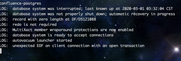

confluence starts and stops. When stopping, postgres gives the following error
LOG: database system was interrupted; last known up at 2020-03-01 03:32:04 CST
LOG: database system was not properly shut down; automatic recovery in progress
LOG: record with zero length at DF/D5121088
LOG: redo is not required
LOG: MultiXact member wraparound protections are now enabled
LOG: database system is ready to accept connections
LOG: autovacuum launcher started
LOG: unexpected EOF on client connection with an open transaction
How to solve this problem. In the previous migration, we also directly packaged the container to decompress and run on the new server without any problems. I don't know what the problem is this time.
