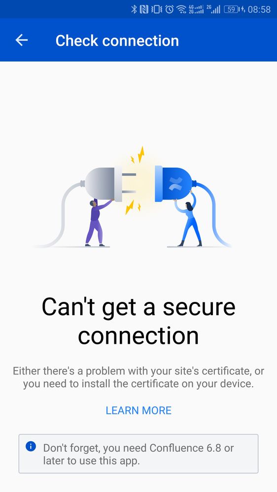

×We tried android app to connect our confluence-server ,also show can't get a secure connection, we have tried to install the cert but still doesn't work, our server has a public cert and trusted by default, so IOS version can directly use the app.
It seems that the app haven't tried to connect to the server at all.

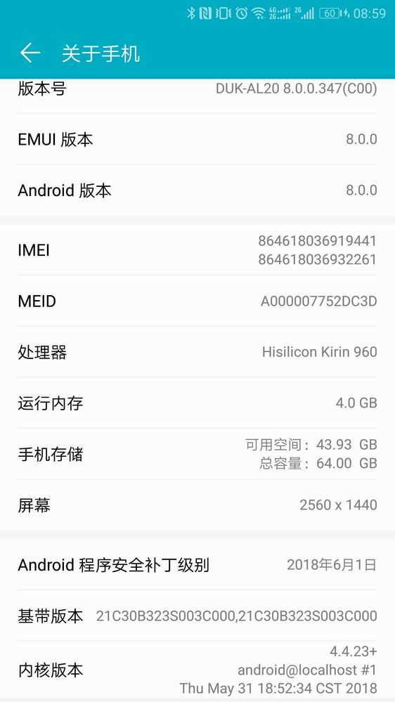

I tried to use the latest version 0.1.40 on two different phones,one is HuaWei and another is Xiaomi
Android version is 8.0
Anyone can help?

I have exact the same Problem. The app works on our IOS devices but on our android devices i have the same problem as described above with one differnce.
When i try to connect the first time everything works fine. When i then close the app it can't connect with the error "Can't get a secure connection". When i now try to connect to our test server i will see the login to the test server. Then i cancel the login and can now connect again to our production server. After closing the app a new connection to the production server won't be possible.

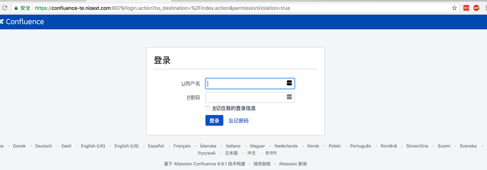

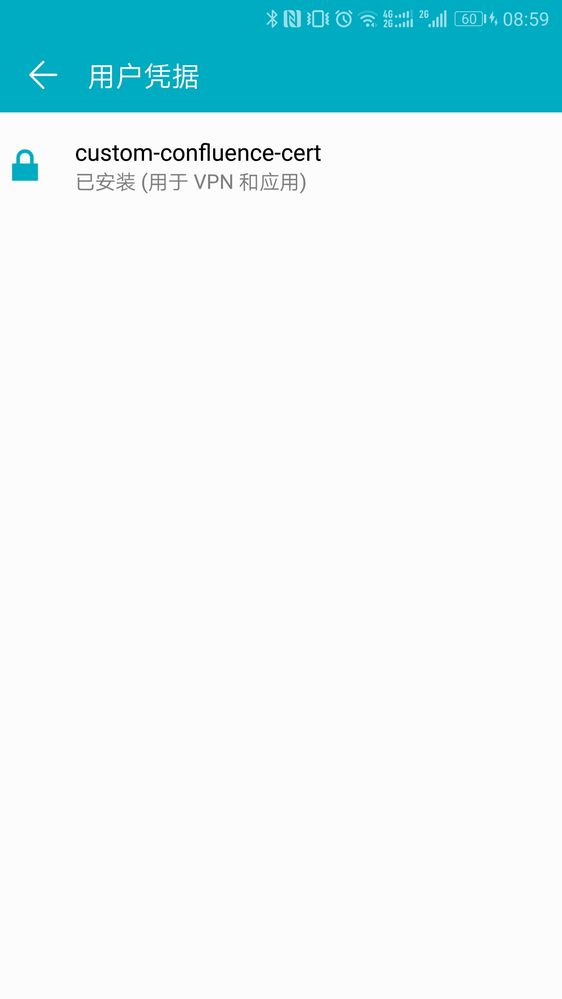

Sorry for all Chinese part since most our users are Chinese.Our website has a regular cert from godaddy so I don't think we need install any cert on mobile device.You can see we visit the https link directly through chrome on the computer show security icon.Also for IOS devices,the app works well.But Android version it always show problem,Both Huawei and Xiaomi we tried.To check I installed our cert on my phone,but nothing changed.It seems like the android version didn't try to connect the website at all then directly show cannot get a secure connection.
