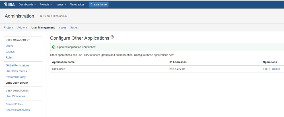

The first step on JIRA side was ok:

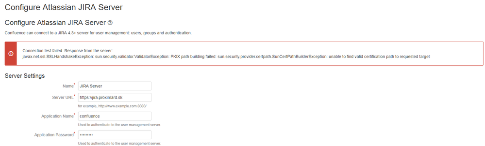

Step 2 on confluence side was not ok.
When entering server URL (for JIRA) the same as JIRA Base URL we get the following error:
Don't know if this has something to do with using SSL for both confluence and JIRA ... ?
Or perhaps it is related to the fact that both jira and confluence reside on the same IP address, just using different ports? How can I specify the ports when linking the applications?
Can you please advise a solution?

Dear @Pavel Ihring,
it seems that the SSL certificate is not known and cannot be trusted. You can either
  1. add the cert to the current keystore of JRE (first long answer)
  2. purchase a valid CA signed certificate (eg. LetsEncrypt)
