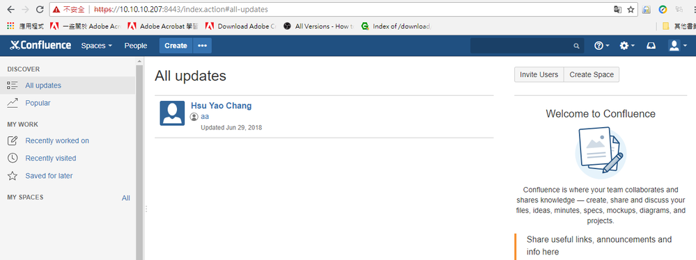

Dear all,

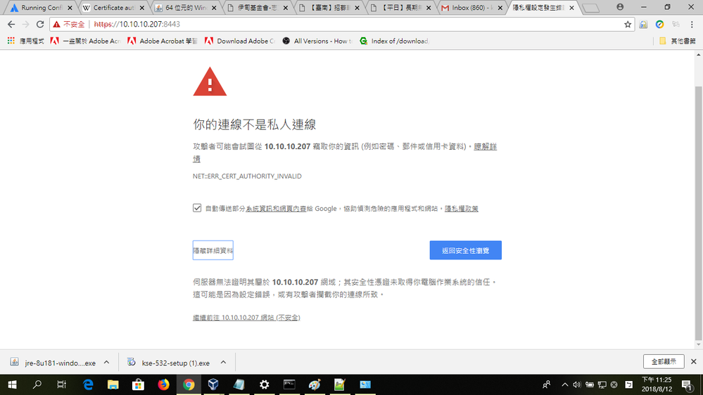

After follow the guidance at the link of https://confluence.atlassian.com/doc/running-confluence-over-ssl-or-https-161203.html, we can connect http://10.10.10.207:8443 (It's intranet lab link, you can not connect in internet) But while it will show the message when we connect it . How can we prevent it ? Although I try firefox and google chrome, it also have the same condition.

Hi Anderson,
Your certificate is working well here, the error message is just there because the Certification Authority is not recognized as legit by your browser (probably using a self-signed certificate). You can prevent this error by buying an SSL certificate from a trusted authority or by having an internal network trusting self-signed certificates (won't be possible on public internet).
Hope this helps!
Cheers
