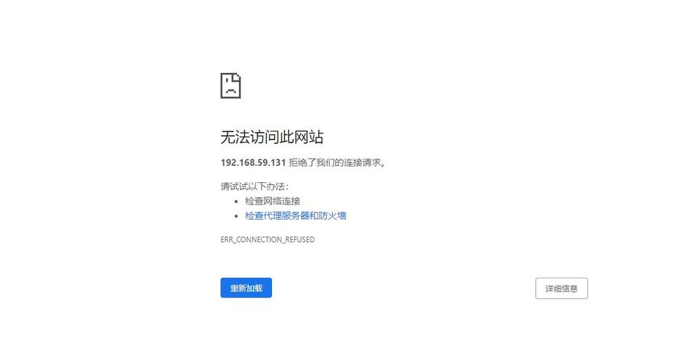

Thank you. It has been modified according to your way, but the conference service can't be started.
Nic Brough -Adaptavist-
April 2, 2021
What errors are you getting?  What does the log file say the problem is?
If you've followed the documentation, the most likely problem is that you've edited server.xml and miskeyed something that has broken it so that Tomcat can't make sense of the file and hence stops when it tries to read it.

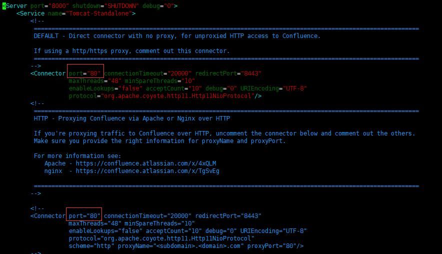

zhan zhao
April 2, 2021

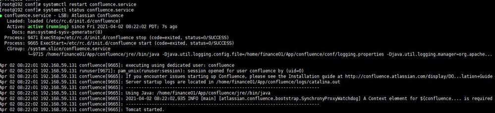

[root@192 logs]# tail atlassian-confluence.log
April 2, 2021
Have another read of the document I linked to - there's a bit in there about privileged port usage that I suspect you've missed.
