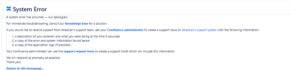

我把confluence的attachments文件夹,confluence.cfg.xml和shared-home文件夹复制到了另外一个系统 并将原来的数据库内容拷贝出来 导入到另外一个数据库 他们之间的版本是一致的 启动后 可以正常登录 不过无法创建文章 尝试过重构索引
这个是日志:
[Catalina-utility-3] org.apache.catalina.valves.StuckThreadDetectionValve.notifyStuckThreadCompleted Thread [http-nio-8090-exec-9] (id=[409]) was previously reported to be stuck but has completed. It was active for approximately [77,369] milliseconds.
org.hibernate.ObjectNotFoundException: No row with the given identifier exists: [com.atlassian.confluence.user.ConfluenceUserImpl#2c9028e68e51289c018e9e32c0xx92ks5]

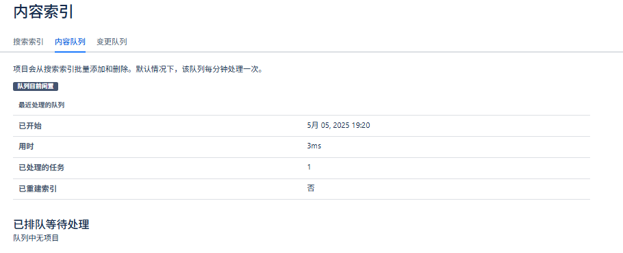

重建了 但是好像没有成功 我是删除index和journal文件夹 然后在UI上点击重建
周皮蛋瘦肉
May 5, 2025
atlassian-confluence-index.log日志发现有报错,内容如下:
2025-05-05 19:19:35,374 ERROR [Indexer: 2] [confluence.internal.index.DefaultBatchIndexer] doIndex Exception indexing document with id: 70975499
org.hibernate.LazyInitializationException: No row with the given identifier exists: [com.atlassian.confluence.user.ConfluenceUserImpl#2c9028e690fb72d4019111f9f3ee0003]
