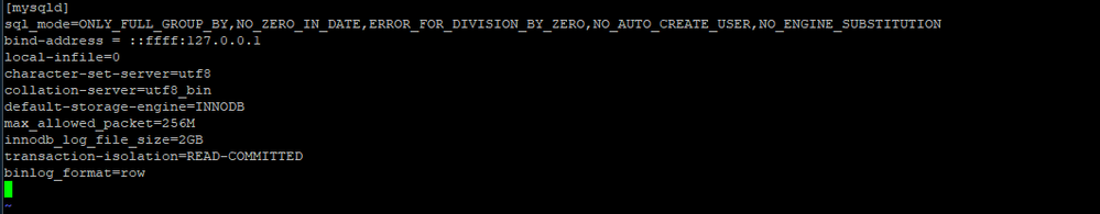

i changed my "my.cnf" as recommended:

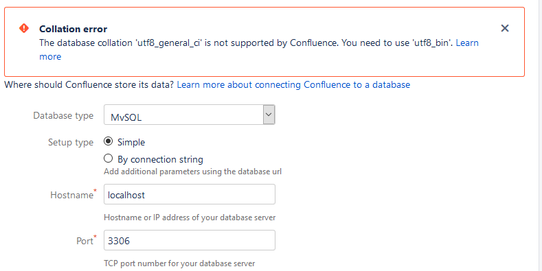

but when i'm trying to install or rather connect confluence to my database i get this error:
please help!

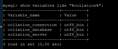

Could you please run this command on MySQL prompt and provide us the results;
mysql> show variables like '%collation%';
thanks
Patrick Einatz
August 2, 2018
Unbenannt.PNGwow, you sir nailed it.... so how can i adjust my collation_connection value... thank you so far.

ok, i managed to set this on my own.... but i still get the same error :-(
any ideas? do i have to do the whole installation process again ?

ok, after adding this to the "/etc/mysql/my.cnf" file
init-connect='SET NAMES utf8'
init_connect='SET collation_connection = utf8_unicode_ci'
skip-character-set-client-handshake
i rebootet mysql and launched following command once again and then it worked
ALTER DATABASE yourDB CHARACTER SET utf8 COLLATE utf8_bin
thank you very much for your help Shankar Asam
