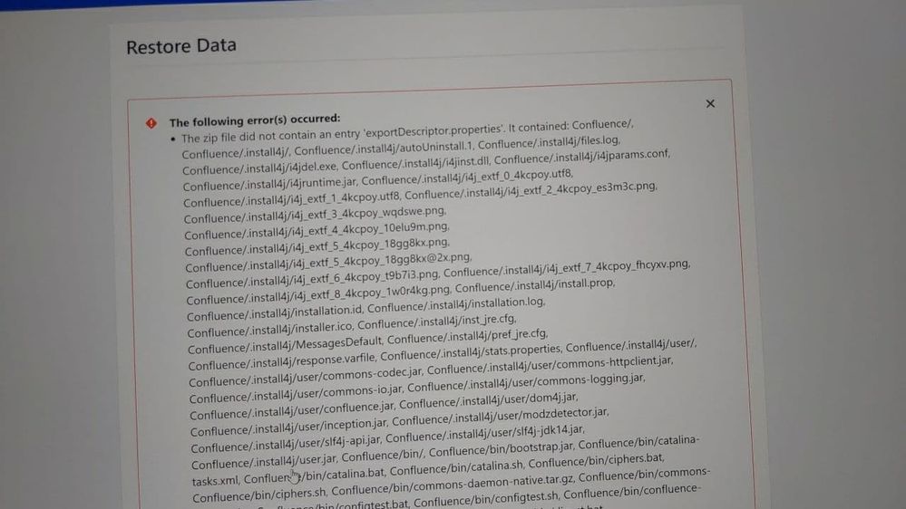

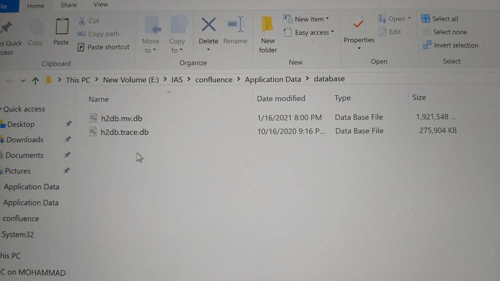

But then I couldn't restore my database dump over the top of the new DB. Because I didn't have a dump file. I just had 2 files their name is: "h2db.mv.db" and "h2db.trace.db".
I continued your steps without "restore database dump". and finally  I encountered this error:
