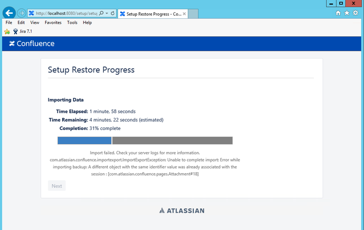

I attempted to upgrade Confluence from 5.4 to 6.0 and then 6.0 to 6.7 but the latter upgrade had failed. Unfortunately, I can't go back to reinstall from the start because SQL server had to be upgraded to comply with the supported platforms for Jira upgrade at the same time.
Below is the error message I receive:
I have tried going through the logs and following troubleshooting guides but it's gotten a bit overwhelming for me as I've been handling both Confluence and Jira. Any workaround or guidance would be appreciated.

March 6, 2018
My recommendation is to restore the database and home directory to the last working version (6.0?) and then follow Upgrading Confluence. Please note from the doc I linked:
XML backups should not be used to upgrade Confluence.
