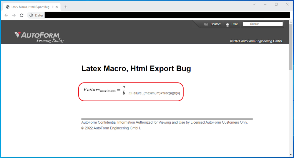

When I try to export Formulas (I´ve created with the Latex Macro in Confluence) with the HTML-Exporter there is a bug regarding to the Html output.
So it seems that the formular is shown correctly, but the Latex "source code" is also shown after the formula:
Does anyone know how I can fix this?
Thank you very much.

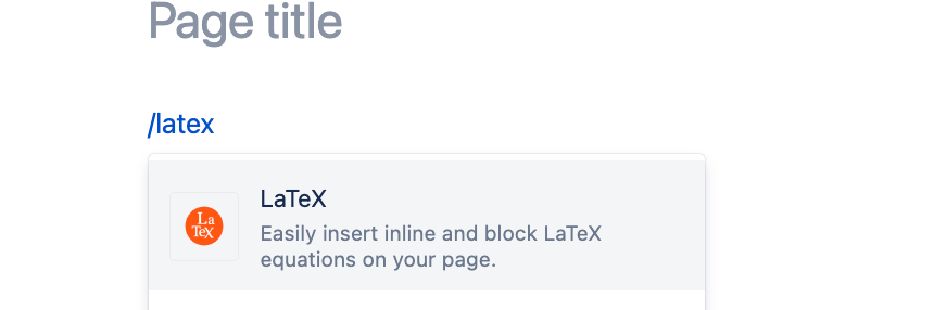

What app do you use for Latex formulas?
Maybe Content Formatting Macros for Confluence
