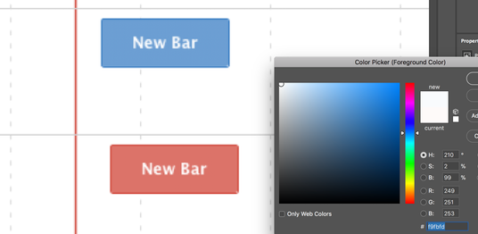

What version of Confluence are you running? I tested with my Confluence version 6.7.0, and using the inspector I can see that the CSS is set to white, but has a fade setting.
When I export this to PDF, it still appears white, but using a dropper tool in Photoshop, I can see that it does add a little bit of whatever background color the bar is using. The below example is from my PDF:
Could you show me what you're seeing? I'm curious to know why it might be changing it to such an unreadable color for you.
There's no way around this that I'm aware of, but if it's not readable then this is something that should definitely be reported.

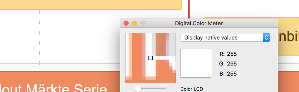

We are running Confluence 6.2.3
This is web view

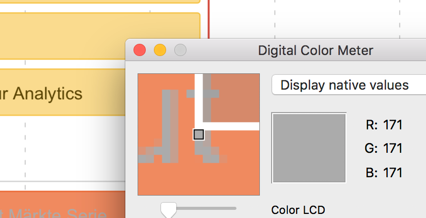

and this is from the PDF Export

Konstantin Prinz
February 12, 2018
I have been playing around with Chrome and then it dawned on me. I forgot sth: Since it's pretty pixely if I just hit 'export to PDF' (and then it IS in white) what I actually did was to define an A0 Format for my HP M277dw printer and then use Apple's 'save as PDF' from the print dialog. And THEN the grey appeared. Sorry about the omission in the steps.
