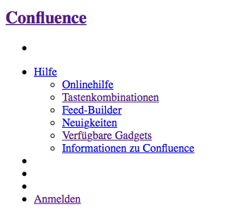

I have installed Confluence on a Ubuntu box. The default config (using Tomcat directly on 8090) works fine. But the config with Apache and SSL fails because only links and basic HTML elements are visible. The skin (colors, frames, menu, layout, etc) is missing.

The two proxy pass lines should not have quotes and the proxies should be consistent - all terms should end with or without a /, don't use a mix of them.  Please fix those and retry it.
