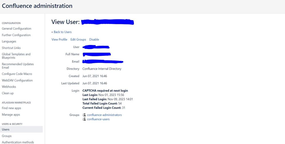

Can you send me a screen shot of user management where you see failed captcha?
Only user part no sensitive data
BR, Olga
Christopher Saunders
November 9, 2023
