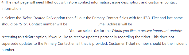

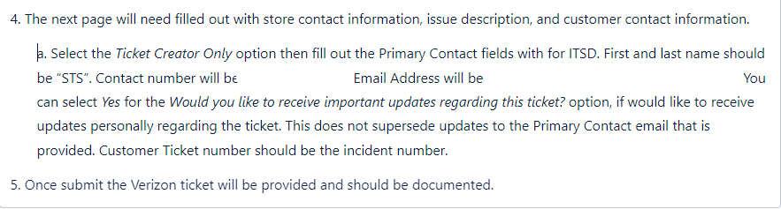

I have been trying to create indents using the tab button in the center column of a three column layout macro. But whenever I publish the page, the indent disappears. There is no numbered or bulleted list. Due to other restrictions and formatting issues with linking pictures in numbered lists I have been creating them manually.
Below are the examples of the Edit page on top, and the Published page below it.

Hi @Julie d_Antin _Elements_  I am running into similar problems with the indentation. As you point out, the indentation survives publishing when it is outside the layout columns. However, upon my testing, the behavior differs depending on the page width.
In a full width page layout, indentations in layout columns are removed upon publishing (although being visible in preview, which is a very bizzar user experience). But if you work withing the narrow page settings, indentations are published correctly even in layout columns.
