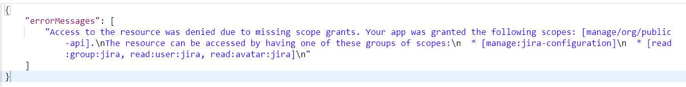

When I used the REST API from the documentation to get the list of users in a Confluence group using group id,I get the following error. What am I missing here?

Based on your description, and the screenshot provided, it looks like you’re trying to:
  • pull group information from your Confluence site.
  • See which users are part of specific groups.
Considerations:
You won't be able to work with Product groups at the organization level with the Cloud Admin API. The Atlassian management system is arranged similarly to how permissions/restrictions work. Within an Organization, you may have multiple sites, composed of different Atlassian product instances. All of these sites share the organization's user-base, however groups currently are managed at the site level.

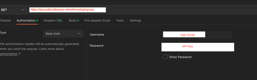

  2. Now that we have an API key for the products, lets hit just the group endpoint with a GET request! I'll be using Postman to demonstrate this.
    1. Open PostMan
      1. Select, GET and Enter the API endpoint url: https://[yoursite].atlassian.net/wiki/rest/api/group
        1. Make note to replace "[yoursite]" with the name of your site.
      2. In Postman, under authorization
        1. Select Basic Auth - see [2] - Product REST API Authentication
          1. Enter your email address in the username field
          2. Enter your API Key generated in step 1 in the password field
        2. This should be all we need for now. Go ahead and hit SEND in postman. You should get back a response body with all the groups you have access to on your site.
          1. Nested within the response body should be the ID(s) of all the related groups.
      3. Below, you'll find a de-identified screenshot demonstrating my Postman setup from the instructions above. GetgroupsViaRESTAPI .png
