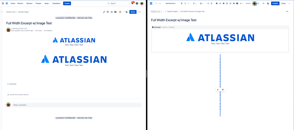

That ticket was marked fixed and closed, but it is definitely still happening. Here's a screenshot of a published full width page and the editor side by side. The page consists only of an Excerpt with an image, followed by an Excerpt Include of that same Excerpt underneath it.
I've included alt text under the image so that you can compare the text side to the image size. You can see that the image in the Excerpt is smaller than the image in the Excerpt Include.
Additionally (this is probably a separate issue), if the image in the Excerpt is resized at all (using the handles on the side in the editor), then the Excerpt Include panel on the editor gets shrunk down to almost nothing (in an animated way, ie., it starts large, and then shrinks down). In some cases, I've seen that animation continue in a loop, so the entire page in the editor gets constantly shifted.
Edit_-_Full_Width_Excerpt_w__Image_Test_-_Robbie_Grue_-_Confluence_and_Full_Width_Excerpt_w__Image_Test_-_Robbie_Grue_-_Confluence.png
