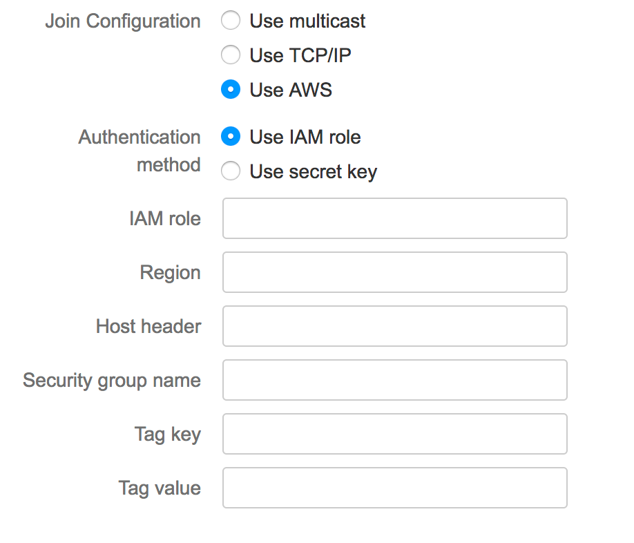

We need more information on what Confluence expects for these form fields. There is no reference to this web form in the Atlassian docs.
• What permissions does the IAM role require?
• What gets populated into the Host Header field?
• What values are required for the Tag key and Tag value?
• What needs to be in the security group that is named?

Hi, Sky from Isostech here :) ...
In general the Confluence AWS Quick Start Template is a good place to start.  The IAM role is on line 1079, and the security group is on line 1823.
    • In addition to the following permissions, some may be required to realize copying the confluence.cfg.xml from other nodes by whatever method you choose.  I usually use an s3 bucket since it does not depend on other nodes being alive or having any special keys.  The route53 permissions are typically not required as well, but they are in the quick start so I've included them here.
      • autoscaling:DescribeTags
      • autoscaling:CreateOrUpdateTags
      • ec2:CreateTags
      • ec2:DescribeInstances
      • ec2:DescribeTags
      • route53:ListHostedZones
      • route53:ListResourceRecordSet
    • I have never needed to use this field for a working data center deployment.  If anyone has any information about when and how this is useful please let us know.
    • This is only used to narrow down the instances that could be Confluence nodes when searching EC2 for other nodes.
    • Ingress from the load balancer security group to the non-proxied port that is configured in $PROGRAM_DIR/conf/server.xml, this is the same port that you will want to configure as the health check port with a path of '/status'.
    • Ingress from the load balancer security group to 443 and likely port 80 as well, depending on how you've configured your https redirect.
    • The following ports will need to be allowed only between the nodes.
      • 5801 - the Confluence Hazelcast port
      • 5701 - the Synchrony Hazelcast port, if not running a standalone synchrony cluster
      • 25500 - the Synchrony Cluster base port, if not running a standalone synchrony cluster
    • Egress to everywhere will be required in every case I can imagine
The only three fields that I typically fill on initial setup are the following:
  • IAM Role
  • Region
  • Security Group Name
When confluence starts it will make a call to AWS metadata for the access credentials of the IAM role.  It will use these credentials to discover the other nodes in EC2.  If your configuration fails for whatever reason and the cluster is not successfully created, you will need to wipe the database and start over.  Editing these values in confluence.cfg.xml and restarting confluence will not work on initial setup.

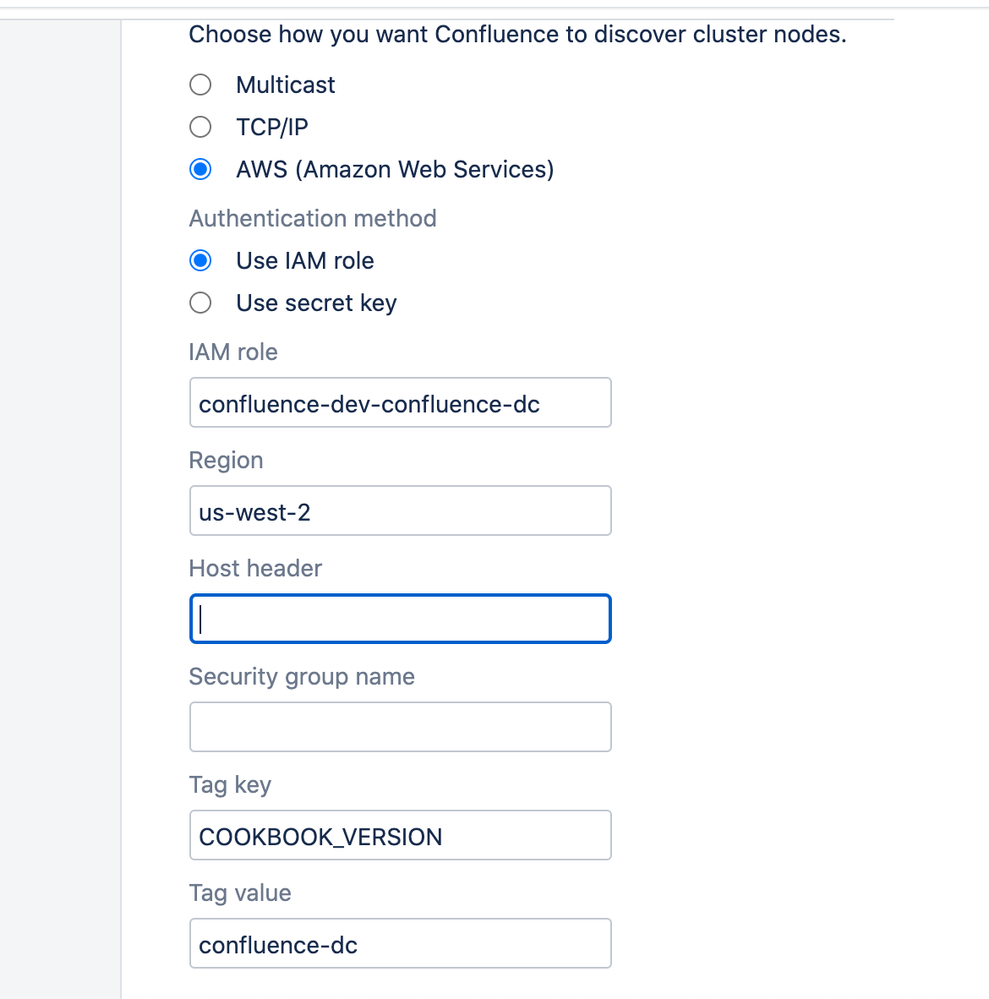

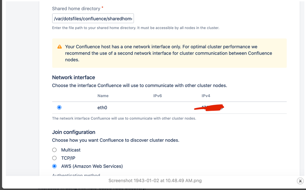

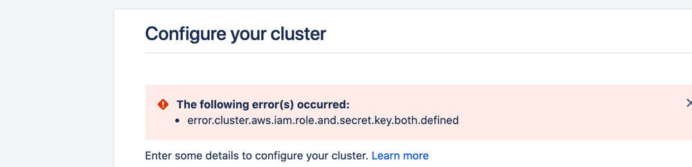

I am also trying to use the AWS strategy to auto discover the peer nodes. However, I am unable to create the cluster. I have ensured the hazlecast jar file exist under plugin directory and the IAM role with required permissions (ec2:DescribeInstances).
Error which showed up in UI  doesn't makes sense as I am using only IAM role not both.
Network interface which confluence grabbed not associated with any of the host in AWS. Confluence log has the following error
[atlassian.confluence.cluster.DefaultClusterConfigurationHelper] getJoinConfig Could not get cluster config from configuration file: The address 'null' is not a valid network address
Screen Shot 2021-03-30 at 2.39.09 PM.pngScreen Shot 2021-03-30 at 2.40.33 PM.pngScreen Shot 2021-03-30 at 2.41.37 PM.png
gangadhar
March 30, 2021
Network interface which confluence grabbed not associated with any of the host in AWS. Confluence log has the following error - we are running confluence in container, the ip cluster grabbed is the docker container ip address.
