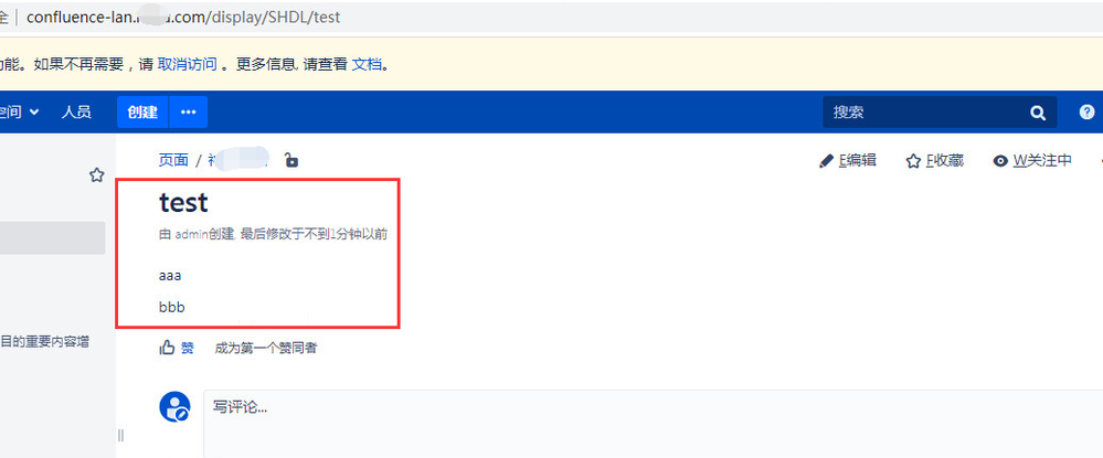

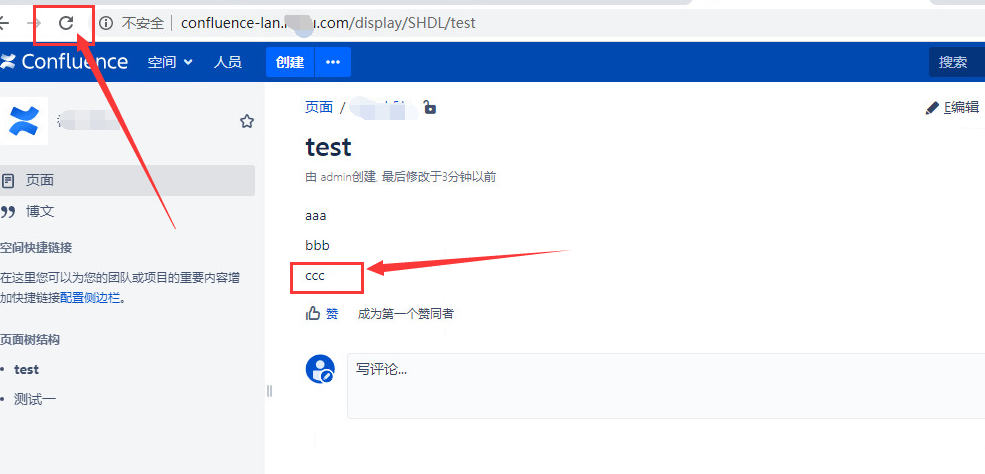

When I opened Confluence using the domain name conflulan.my.com. All right, then I'm going to edit a document.

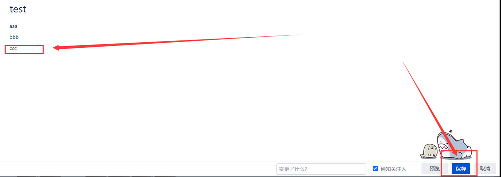

I'll start modifying it now, insert CCC under BBB, and save it.

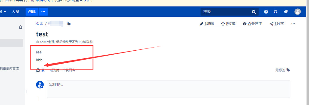

Here's the problem: I didn't see my updated CCC immediately after I saved it
I don't see the CCC I just wrote
When I refresh the page, the new CCC content will be displayed.
Is this a bug in Confluence?

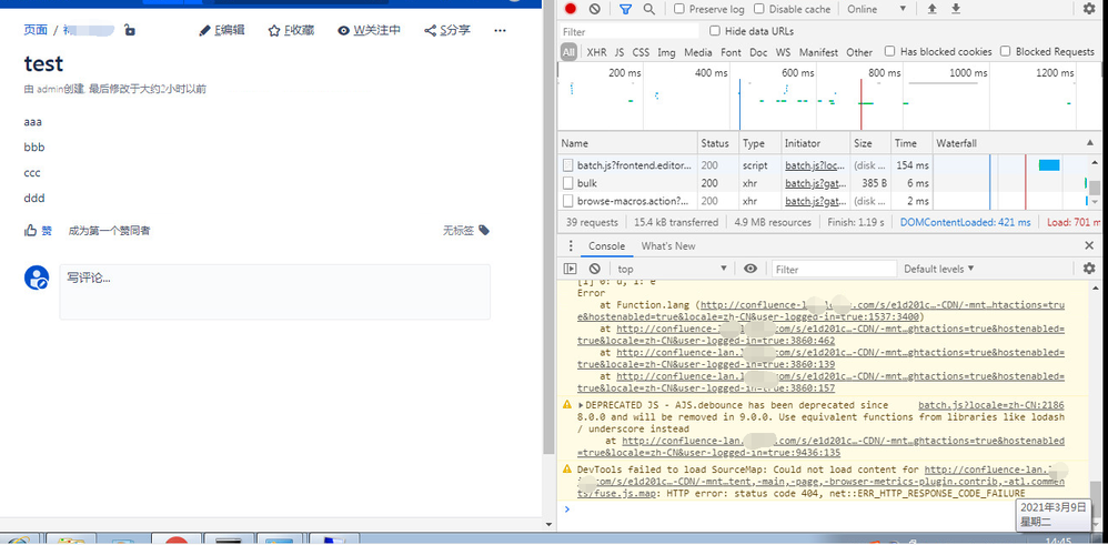

Could you also, double check the errors via console log in dev tools of your browser, please?
Cheers,
Gonchik
陈土锋
March 8, 2021
Hello, the browser console did not see an error:

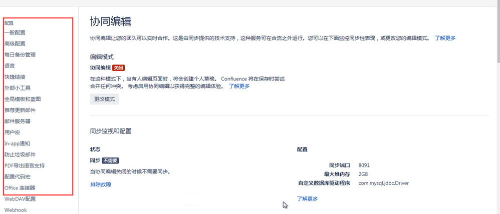

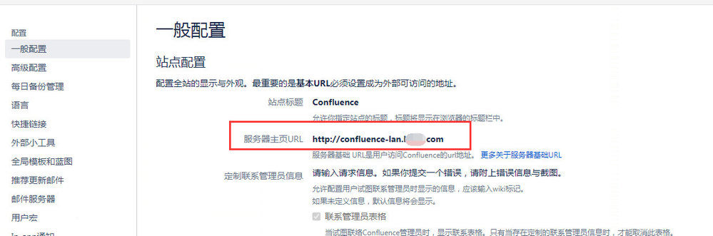

So please, share confluence version?
And share the configuration of Synchrony in admin panel of confuence.
I think it's misconfiguration
Gonchik Tsymzhitov
March 8, 2021
Also, I see different proxy passes
proxy_pass http://localhost:8091/synchrony;
proxy_pass http://192.168.30.207:8090;
陈土锋
March 8, 2021

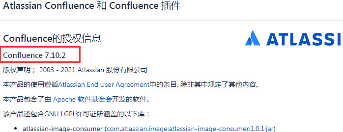

My Confluence version is 7.10.2:
Which configuration would you like to share?
The configuration of my page is as follows:
