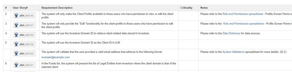

Please see attached screen shot. This is from confluence, when I add more to the description of let's say row 2, I don't see that information being reflected in Jira issue IINT- 56.  Thanks, KapilConfluence_Jira_Issue.jpg

Editing the requirement on the Confluence table does not update the requirement in JIRA. I have tested this.

The contents of that table are Confluence data, not Jira fields.  So they're not going to update the issue - they're nothing to do with it.
