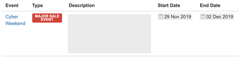

I figured that if we made a page template, and used it to make one page per event, we could include a Page Properties macro that would for example record the type of event, a description, the start and end dates, like this:
There'd also be a separate set of dates to determine when this event should be 'flagged', e.g. this year the event is from 29 November to 2 December, but for our customers the build-up to this period is just as critical, so maybe we'd start flagging the event at the beginning of November, to remind everyone of the stakes involved. Starting 1 November, the idea would be for everyone to see something like this:
