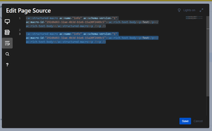

Here, possible alternatives that can save 5 seconds are working with the Storage Format (especially if the macro you need is basic) and adding the code to each page, as it opens faster.

I believe the Source Editor might be just the tool I was looking for. It might not be a "mass editing plugin"-tool, but it will definitely shave off enough time, to make it feel like I'm making progress.
