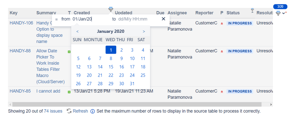

Please define the "date function". If the problem is that you need to work with different kinds of dates (created, updated, etc.) but you are tired of going to the page edit mode and changing the JQL inside your Jira Issues macro, we can suggest using additional apps from the Marketplace.
For example, here is a screenshot of our Table Filter and Charts for Confluence app (its Table Filter macro) in combination with the Jira Issues macro:
Here we filter issues only with the "In Progress" status and created later than 01/Jan/20.
The screenshot was taken in the page view mode, so you don't need to change any JQLs and can filter you issues (create pivots) on the fly.
