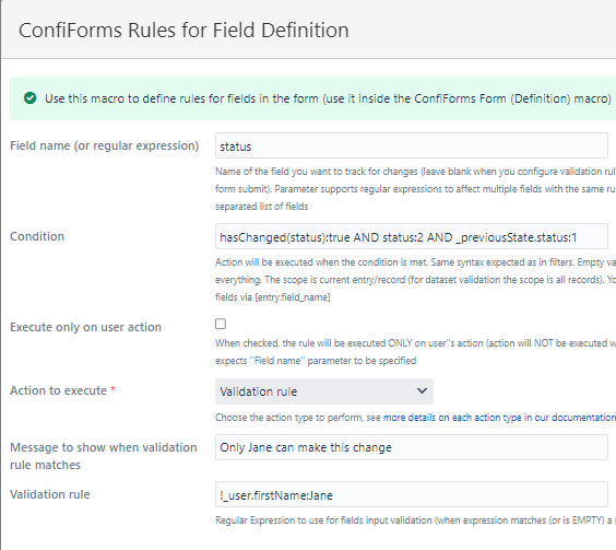

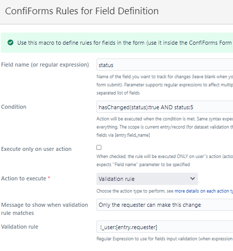

I have a form that includes two fields: status (field type dropdown) and requester (field type user). I am trying to create two separate validation rules:
  1. Allow only one person (first name Jane for example) to change the status from status:1 to status:2
  2. Allow only the person who made the request to change the status to status:5
I used Rules for Field Definition macro. Here’s how I set it for the first rule:
Capture.PNG And the second rule:
I can’t get either one to work. For the first rule, when I test it and change the status from 1 to 2, the validation rule always executes even if I (as the current user) is myself or login as Jane. Similarly for the second rule, if I change the status to 5, the validation rule executes even if I am or am not the requester.

Hi @NA1021
For your first rule remove the "Validation rule" parameter value and set the "Condition" parameter to be
hasChanged(status):true AND status:2 AND _previousState.status:1 AND !_user.firstName:Jane
And for your second rule, also remove the the "Validation rule" parameter value and set the "Condition" parameter to be
hasChanged(status):true AND status:5 AND !requester:[entry._user]
Alex

So I created a simple form like you did with a status field (dropdown) and a requester (user). Rule 1 worked. But Rule 2 , which had this condition as you suggested,
will always trigger the rule whether the current user is or is not the requester.
But if I changed the last AND clause and reversed it
hasChanged(status):true AND status:5 AND !_user:[entry.requester]
it would work correctly and only trigger if the current user is not the requester.
Does the order of the two comparands matter in a filter? In my case it seems to work one way but not the other.
