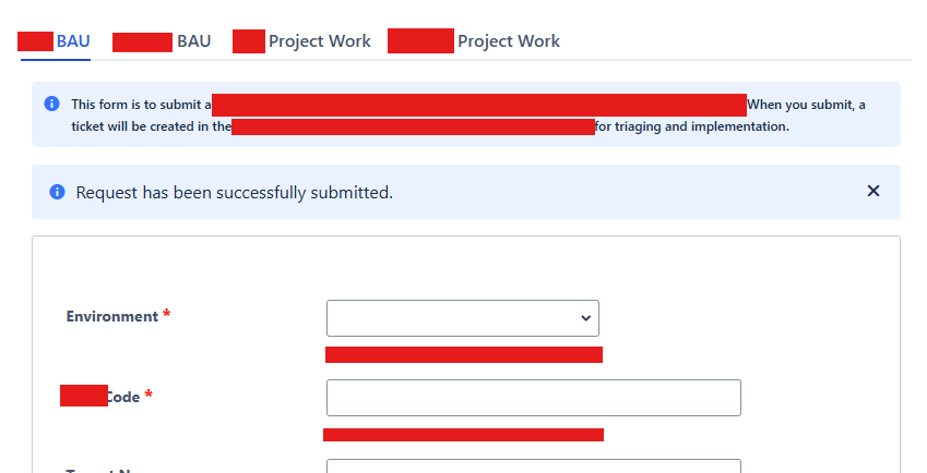

Here is an example of where the message (Request has been successfully submitted) shows up after Submit is clicked on any other tab .. it seems to be above the Confiform itself.
(note I blotted out words that are unique to my company to be extra cautious :) )

What I showed was a screen showing the contents of the first tab after I submitted a Form from the third tab. If I was to show a screen cap of the 3rd tab, it would look the same however the message "Request has been successfully submitted." would not appear there even though that is the tab from which I clicked Submit. I only see that confirmation message when I click back over to the 1st tab.
So the problem is this: my users will submit requests on forms from any one of the 4 tabs ... When they click Submit, they will only ever instantly and easily see the confirmation message if they submit the form on the 1st tab. If they submit on the 2nd, 3rd, or 4th tab, no confirmation message is shown which will lead them to think that the submission did not succeed (regular users will not think to switch over to tab 1 after submitting on tab 3 for example to look for a confirmation message).

Oh, you have separate forms in each card!? It is not one form that is configured in different cards, but many forms?
OK, I see. Thank you for clarifying. I afraid there is no better solution than to have a custom “success message” that tells which form was submitted. It will still be shown in the “first card”
