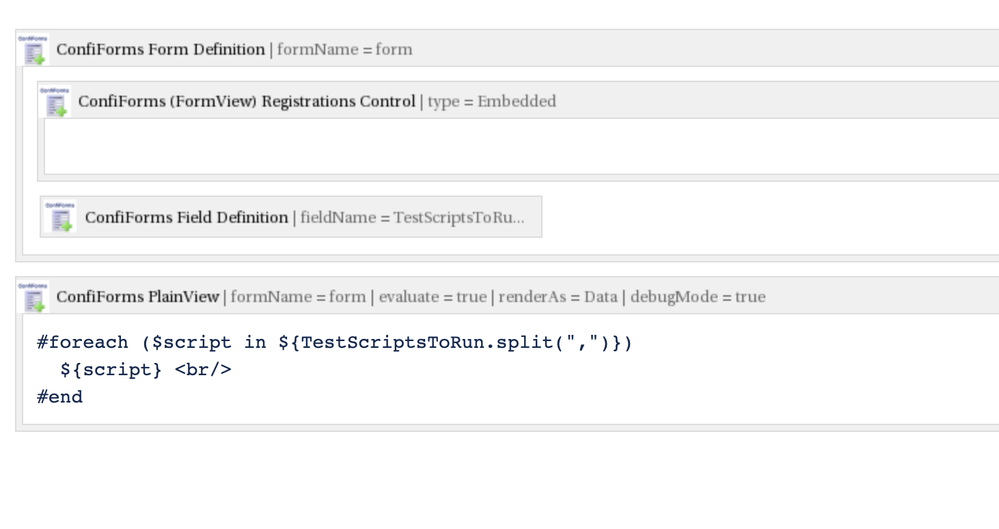

Something like this
#foreach ($script in ${TestScriptsToRun.split(",")})
${script} <br/>
#end
(of course not the <br/> in there... I just did a test with a PlainView for a quicker debugging method)
Alex
Thanks Alex! I got the above working in PlainView, now I'm working on the second condition (the if statement) that will allow me to push add in the correct closing bracket for the JSON, but only for the last item in the split.
