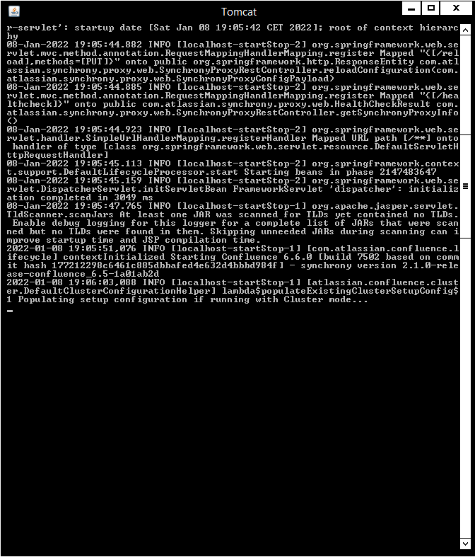

Upgrade to 6.0.1 worked! Upgrade from 6.0.1 to 6.6 now. Which looks good, but it seems to get stuck at this point. (image attached)

Anyone any idea? Is my screenshot clear?
Nic Brough -Adaptavist-
January 12, 2022
We'd need to see the rest of the log for the full errors.

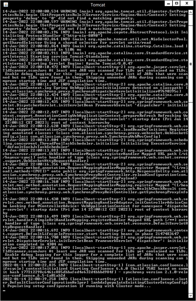

After upgrading to 6.6 it seems to be stuck here while starting confluence
