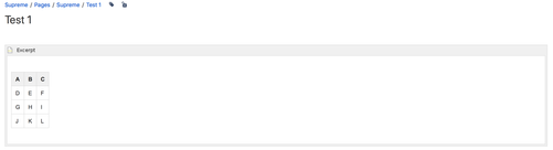

Master table

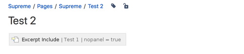

Child table
Any changes done in the master table will be reflected in the child table respectively.
For reference, please check on the official documentation here - Excerpt Macro and let me know if that works for you. Thanks.

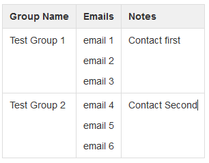

Ahmed, so far this is so close to the answer I need. I was able to create a master list and connect that to a different page.
The issue I am running into is that I want to be able to only show a portion of that information from that list to each issue.
Ex. In two separate areas in Conflunce I need to reference just Group 1 from the Master List. In another area I need to reference Group 1 and Group 2 info to be inserted from the Master List.
Is there a way to pull pieces from the Master List? Or is it all or nothing?

September 24, 2018
Hi, Jeremy.
