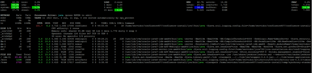

Can you run a grep on confluence user and also on java processes to show us what all java processes are running and what all processes are owned by the user id confluence.
Javier Guarinos Ibañez
November 11, 2019
this is the result

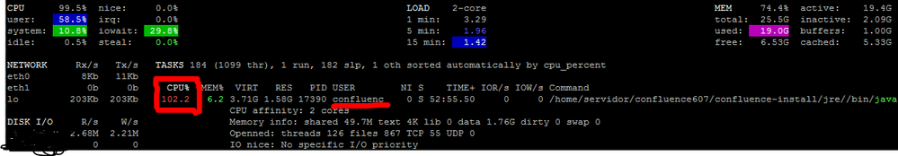

November 11, 2019

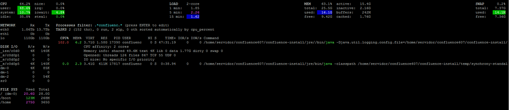

November 11, 2019
CPU problems begin when some user launch processes in another application. For example, in this image a user has launched jenkins and slows down other users.

So it doesn't look like Confluence is the problem there. CPU usage seems to spike at every instance of any process running in that server.
How many CPU cores does the server have ? Maybe you can work on it and hike it .

Yes, what misses me is so much CPU usage by confluence, being "clean" - freshly installed .... In the last image that I have put, I have asked a user to launch a laborious task in Jenkins. From what I think, that CPU usage is normal at that time. What doesn't seem normal to me is the constant 24/7 CPU usage by confluence. And for that, this query.

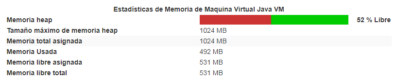

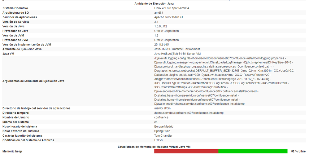

So, how much memory you have actually allocated for Confluence JVM?
And do you have an "empty" Confluence or have restored some backup/spaces? In this case the Confluence index might be the cause (to rebuilt the index)
November 12, 2019
I will start the service and put a screenshot of Confluence's memory.
