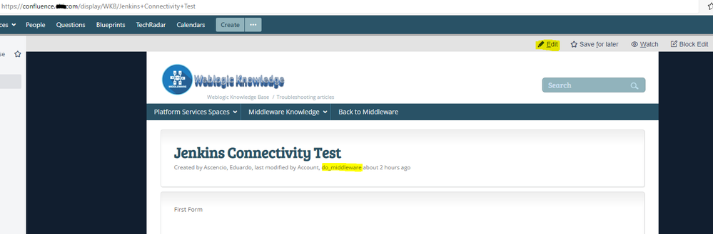

As you can see from Jenkins I'm using a variable that it's supposed to contain the API Token (I did not create it as I lack enough permissions, it was already there). This credentials are stored as:
  • Secret text - a token such as an API token (e.g. a GitHub personal access token),
The resulting file from running the pipeline has a 500 error, is this enough to say that at least the credentials are correct and it connected to Confluence?
Seeing the tests from Unix it seems this user has no access, but when I connect through browser I'm able to write on that page:
So I guess my issue could be related to me not using credentials properly
Sorry if my questions are too noob type.

Lalo Ascencio
January 26, 2022
As you can see in my previous Screenshot I can connect  on UI (through browser) with same credentials but I can connect using CURL. That is why I think I may need to apply an additional step to my credentials. Can you confirm?
