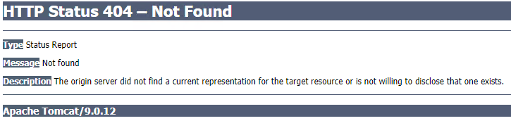

I have uninstalled PostgreSQL11 and then install PostgreSQL 10 and then edited the Confluence.cfg.xml file to point to the new Postgre database. however, I am getting the following error message when I start the services.

Unfortunately, editing confluence.cfg.xml to point to the new, empty database will not allow Confluence to start. Rename or remove confluence.cfg.xml and restart Confluence. You will need to complete the setup wizard, where you will setup the database. Confluence will connect to and populate the database. After the Wizard, you can Restore your site. Cheers!
