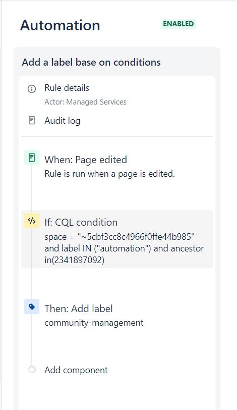

There surprisingly scare information regarding the usage of CQL imho. I was not successful on finding a way to trigger automation with the trigger "Move" page, but I found that if you make the trigger run on Edit OR if you schedule it to run once a day in the following CQL condition
space = "~5cbf3cc8c4966f0ffe44b985" and label IN ("automation") and ancestor in(2341897092)
You will find that it accomplish almost the same outcome. It will looks like this:
If you grab the link to your parent page you can find the space id and the Ancestor page id :
https://xxxxxxxx.atlassian.net/wiki/spaces/<space ID>/pages/<Ancestor page ID>/<Ancestor Title>.

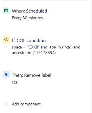

Thanks so much for the comment. It looks like I'm about 95% there. I tried implementing a version of this for some testing (use case: if a page is a child of a certain other page, and it has the "rca" label, then remove the "rca" label):
When I validated that CQL, it confirmed the query was valid and that 19 contents were found (which matches what I expect). However when actually running this rule, I get an error:
No CQL-compatible content found in the rule context; there is nothing to check against the CQL query. The CQL condition component can only follow components that involve CQL-compatible content, such as the blogpost published trigger, the publish new page action, or the related entities branch.

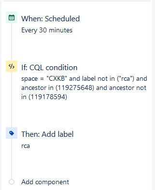

I also implemented a rule closer to your original suggestion (use case: if a page is a child of a certain other page, and does not have the "rca" label, then add the "rca" label):
This had the same problem - while the CQL condition did validate successfully and return the expected number of pages, it did not run successfully and gave the same error message.
