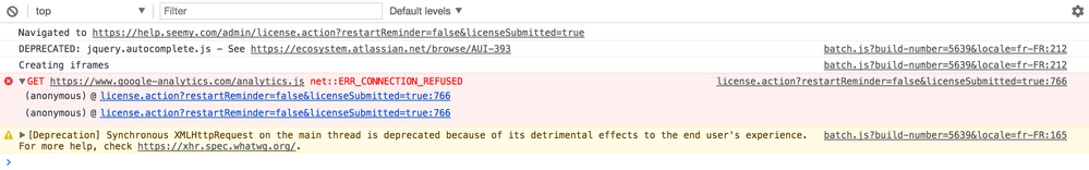

Pierre-Yves MESTRE
October 7, 2017
Hi and thanks for reply,
I got this in the console :
And how can I join a file to the post ?
About the proxy conf, I don't have a proxy,
And I have correctly update the Jira software and Bitbucket.
Andy Heinzer
October 9, 2017
I have created a support request to gather this additional information from you.
