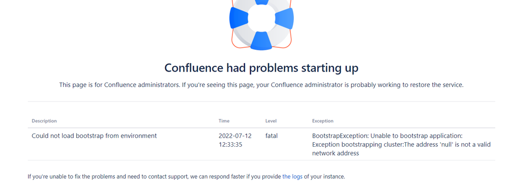

I am facing an issue while starting up the confluence and getting the below error:
The address "NULL" is not a valid network address. (screenshot attached)

This suggests that there is an error in the node's configuration files - it can't read a network setting.
Check the <Confluence Home Directory>/confluence.cfg.xml is valid and has the right network settings for the cluster defined.
