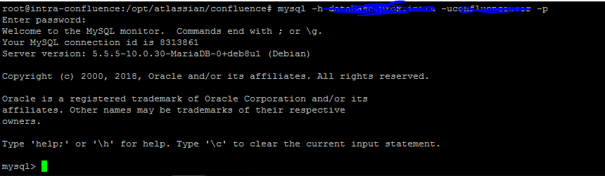

Find config here : https://paste.proxgroup.fr/?61fe58b983cc0fc1#p/gn/AuB6jmt8ECyvGfl2s+W/FmNwjKU3mRTJtsi5us=
SMS
February 6, 2019
Hello,
Thank you for checking that. I noticed that you're using MariaDB, which is not supported.
You need to make sure to use MySQL 5.6 or 5.7.

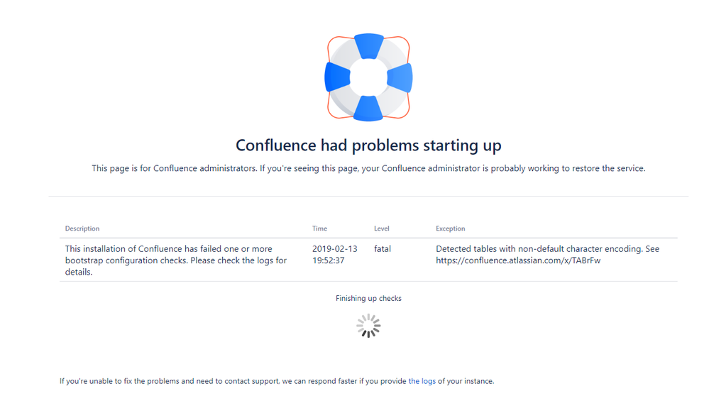

I moved my database from MariaDB to MySQL 5.7 ( Dump, database création following requirements, import database dump ).
I'm still not able to get Confluence working.
atlassian-confluence.log : https://paste.proxgroup.fr/?1f6cbf603c84984b#wpa+4LnM/Ck75bkLr00Z3U+4vA3qcbCrZFE4EjMqmjo=
catalina.out : https://paste.proxgroup.fr/?bf7c656e5283f0b5#tmo2orooF1bvfefOz3mQh6aAOh4VoQ0fczZ8nW7wn8E=
In the log, you can see errors about database encoding but i already followed this KB : https://confluence.atlassian.com/kb/how-to-fix-the-collation-and-character-set-of-a-mysql-database-744326173.html

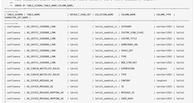

If you run these queries on the database, see what comes back. It should tell us what specifically is triggering the error:
use <your database name>;
show variables like "character_set_database";
show variables like "collation_database";
show variables like "storage_engine";
show PROCEDURE STATUS;
show FUNCTION STATUS;
show TRIGGERS from <db name>;
show FULL TABLES IN <db name> WHERE TABLE_TYPE LIKE 'VIEW';
SELECT TABLE_SCHEMA,
       TABLE_NAME,
       CCSA.CHARACTER_SET_NAME AS DEFAULT_CHAR_SET,
       CCSA.COLLATION_NAME,
       COLUMN_NAME,
       COLUMN_TYPE,
       C.CHARACTER_SET_NAME
  FROM information_schema.TABLES AS T
  JOIN information_schema.COLUMNS AS C USING (TABLE_SCHEMA, TABLE_NAME)
  JOIN information_schema.COLLATION_CHARACTER_SET_APPLICABILITY AS CCSA
       ON (T.TABLE_COLLATION = CCSA.COLLATION_NAME)
 WHERE TABLE_SCHEMA=SCHEMA() AND C.DATA_TYPE IN ('enum', 'varchar', 'char', 'text', 'mediumtext', 'longtext')
 ORDER BY TABLE_SCHEMA,TABLE_NAME,COLUMN_NAME;
Regards,
Shannon
SMS
February 13, 2019
Thank you!
It does appear that your collation on your database is incorrect.
You'll want to try to alter the collation and character set, making sure to make a backup before-hand.

Association Proxgroup
February 13, 2019
Hello,
After running your commande, now i'm in utf8
http://paste.proxgroup.fr/?d41a95d0230105b5#6aZi13m1GvRiZaKOweAmO+pe+udQgxrsJjhOgW4q8yI=
But i'm still not able to start Confluence
