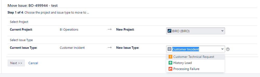

Hi Team,
 While we are moving the jira ticket from one project to another, not able to see the issue types from the target project, when we entered the name its taking. Please find the attached screenshots for your reference.

The two screenshots look like they are from two separate, differently configured, systems (like a production system and a test system that was a copy of production)
Could you confirm that this is the case?  Or explain what you are doing differently in order to get two totally different screenshots?
Assuming it is two different systems, the answer is simple - the issue type scheme for project BIRO in one of the two systems is different.  It has to offer you a different list.

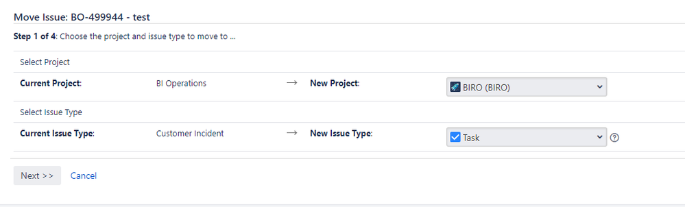

Hi @Nic Brough -Adaptavist- ,
 No, both are from same production and same moving wizard.  In the first screenshot i wasn't able to see the Task issue type, but when i typed in the second  screenshot, i was able to see the task issue, ie the target issue type to move BO to BIRO project.

Hmm.  I've managed to replicate that, and it looks like a bug.
I'm going to guess that you get an error if you actually try to commit to this change, because what I think is happening is the "task" is initially hidden from the list because it's not a valid choice, but the typing lets you specify it.
Could you confirm what happens when you select next and follow it through the move process?

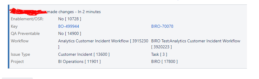

jira_admin_cu
September 23, 2021
 I was able to move the ticket successfully.
September 23, 2021
Ahh, hang on, you've changed project there as well.  That makes perfect sense - the original project has one list of valid issue types, the new one another list.  That's why the options change - you're moving across projects.
