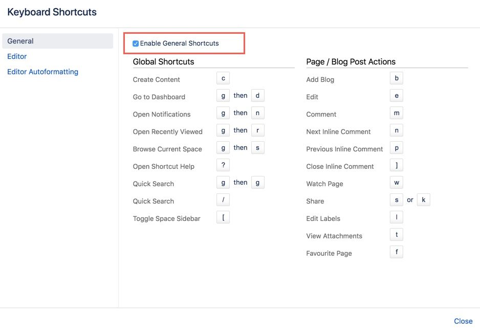

Hi @Molly Kunstler
Can you please check the below as shown in the screenshot.
comm_12.jpgThanks,
Manisha

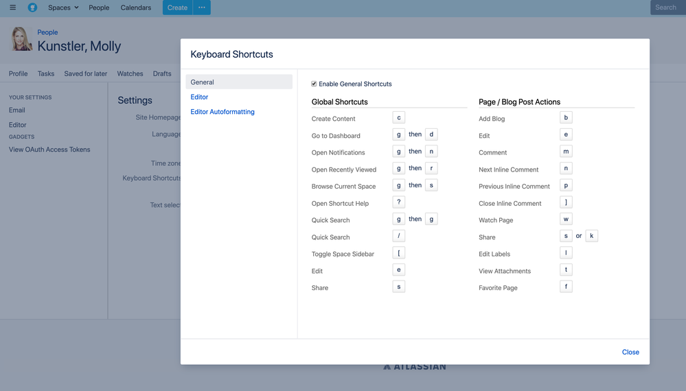

Hi Manisha.
Yes, enable general shortcuts is checked.
Molly Kunstler
May 14, 2020
It has not resolved my issue as it was already checked and I am still unable to make text Bold.
