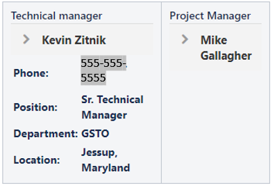

In regular view outside of edit... if someone has profile information inputted it seems to over write the expand ui function and show even though it is placed inside the expand ui box. Below Kevin has profile information so it displays "through" the expand UI.  Mike does not have any profile information loaded so nothing shows.

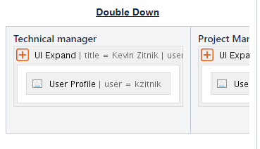

sam October 10, 2019
yes so there is the UI expand.. and the regular expand. They both still exhibit the same thing.
2019-10-10 09_05_26-Copy of JQRs and POCs for testing - Samuel Park - WS Confluence.png
Nesting it twice seems to solve the issue although it will be a pain to double up that macro everywhere. (make a expand macro, place another expand inside, THEN the user profile macro)
