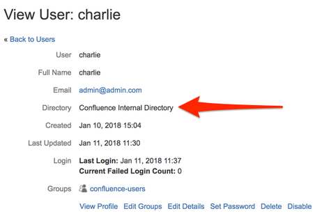

I understand that you can log into Confluence with an account from the Crowd user directory if you do not enable SSO but with SSO enabled, you cannot log into Confluence through Crowd, with a bad username or password message .
By commenting out the default authenticator in Confluence's seraph-config.xml you force authentication to go through the Crowd user directory in Confluence. Usually SSO issues revolve around logging in and then not being logged in automatically to other apps. It is unusual to be unable to log in at all.
In this case, I wonder if the user who logs in via Crowd without SSO is really from the Crowd directory. Please verify by checking to make sure that when you log in with Crowd the users that can log in are really in the Crowd user directory, and not the internal directory as shown below:
