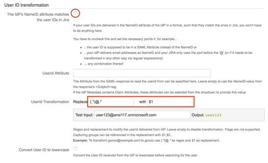

Christian Eitel
February 27, 2018
Hi @ankit singhal,
to turn on the UserID Transformation for dropping the domain part (@domain.com) from the Username (userid):
  1. Goto SAML Single Sign On configuration page (https://<baseurl>/plugins/servlet/samlsso/admin) -> Identity Providers -> User ID transformation
  2. Disable the checkbox The IdP's NameID attribute matches the user IDs in Jira. It should open further configuration fields.
  3. In the Userid Transformation field use
    Replace: "(.*)@.*"    with: "$1"
  4. In the Test Input field below, add your Username. Check that the entered username is correctly transformed to the Output.
  5. Save the configuration page and try it again.
Here is a full screenshot of the configurations:
I hope this helps.
Best Regards,
Christian
