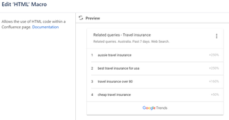

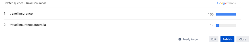

I'm currently creating some dashboards on Confluence, but I'm having problems when embedding a chart.
I'm using Insert HTML macro. When I preview the chart, after copying and pasting the embed code, everything seems fine. However, when I preview/publish the page the charts are not working properly. (As you can see the images below)
1. Preview (working fine)
2. After publishing (only can see half of the chart)
Can you any help me with this issue?
