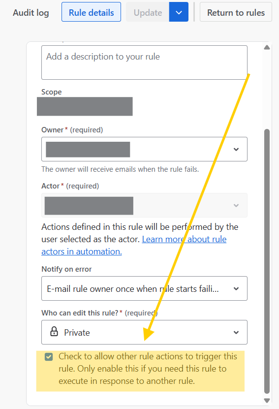

In the Confluence Cloud Automation Rule Details, there is a checkbox "Check to allow other rule actions to trigger this rule. Only enable this if you need this rule to execute in response to another rule." at the very bottom (see screenshot below). Is there a way to trigger a specific Confluence Cloud Automation Rule from another rule?

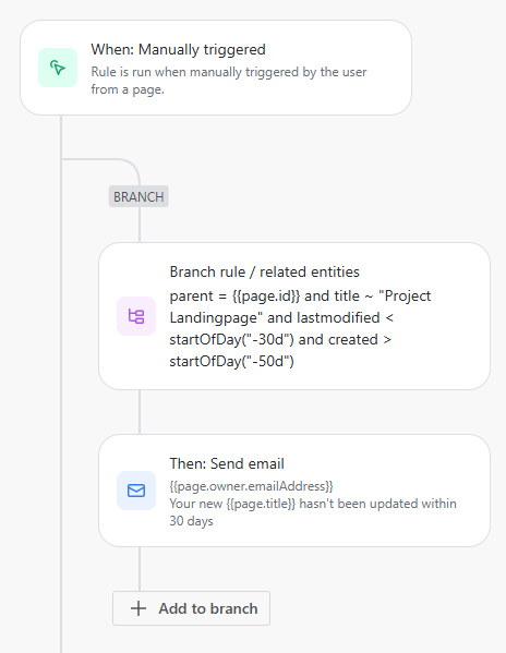

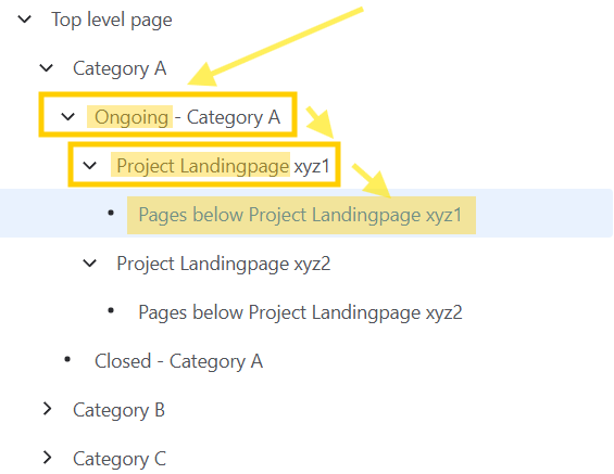

Please take a look at my example screenshot below: First, I want to get all pages which have "Ongoing" in its title. Then I want to get the pages with "Project Landingpage" in its title which have one of this "Ongoing" pages as a parent. Afterwards, I want to check for all the pages below each "Project Landingpage" page when they have been last modified to decide if an automation should execute some action, e.g. send an email to somebody (e.g. the page owner of the respective "Project Landingpage ..."). Now let's say we have around 100 categories and below each, there is a page tree like below Category A, with 0 to 20 "Project Landingpage ..." pages below the "Ongoing - Category ..." page. The check for last modified should be executed for all of the pages below these "Project Landingpage ..." pages, but not for the pages below "Project Landingpage ..." pages which might be already below "Closed - Category ..." pages (as the work on them is already completed but they should still be kept for documentation and reference).

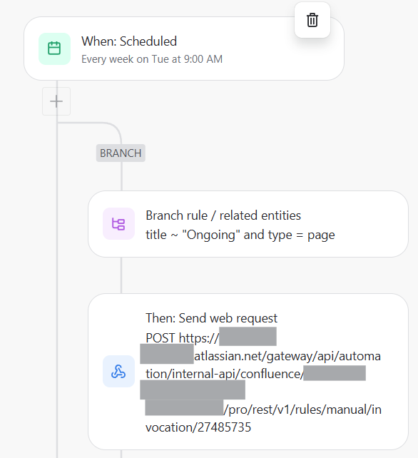

1. Set up a first rule to look for pages with "Ongoing" contained in the title and trigger a second rule for each of the search results
The rule should look like this:
The CQL for "Branch rule / related entities" is: title ~ "Ongoing" and type = page

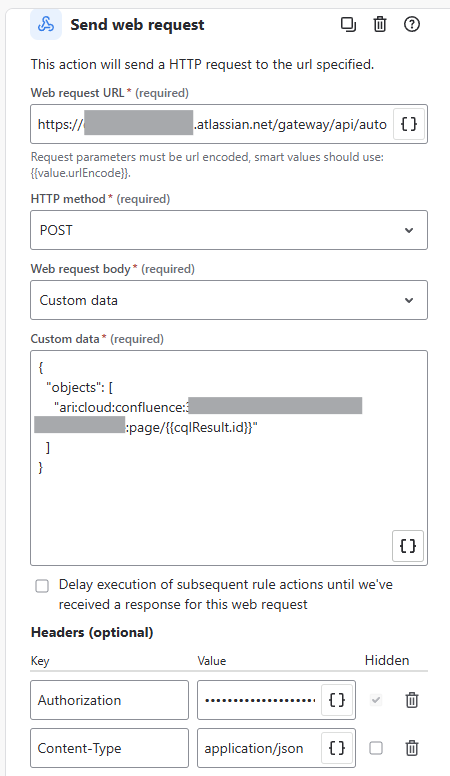

The configuration details for Send web request are shown below:
To get the correct Web request URL and the custom data, you have to setup the start of the second rule already (I will describe this below). So first, let's finish the Headers configuration here:
Authorization: Following the great tutorial by Brad Evans here - don't forget to write "Basic " before the result of your PowerShell Base64 encoding, especially if you click the "Hidden" checkbox and come back later to update it ;)
Content-Type: application/json

Very important: Allow this second rule in the Rule details to be triggered by another rule (see screenshot below).

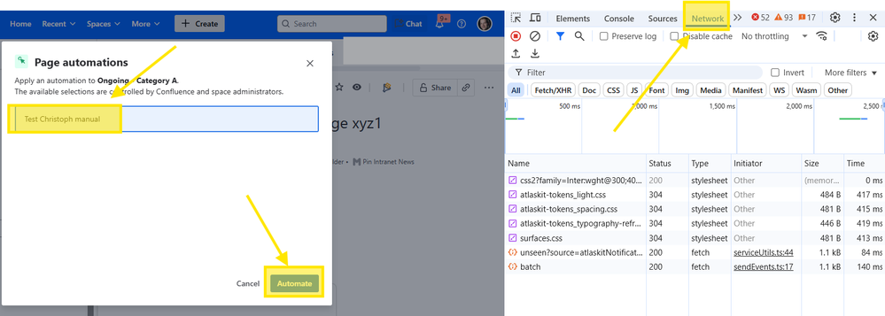

Then (after clicking Update to save the rule configuration and enable it), go to a page in the space you configured your automations for and use the "..." menu as shown in the screenshot below to trigger the automation manually using the "Automate" action:

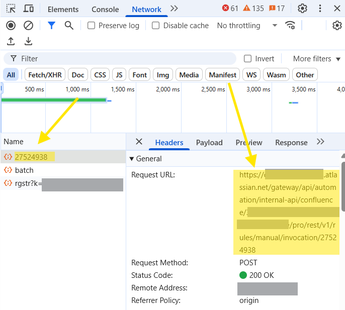

Open the developer tools (for your Browser, Chrome in my screenshot on the right side) and go to the Network tab. Then select the rule you configured in the Page automations pop-up on the left side and click on Automate to start it. Hint: it is a good idea to clear the developer tools data before to spot your rule easier.
Search for the rule ID in the developer tools in the Network tab as shown below (you find the rule ID when you hover over your rule in the Automation - Rules overview), click on it and copy the Request URL in the Headers tab as shown below:
This is the "Web request URL" rule 1 should send the web request to, so open the rule 1 config and paste it there so that it looks like in the screenshots above for rule 1.

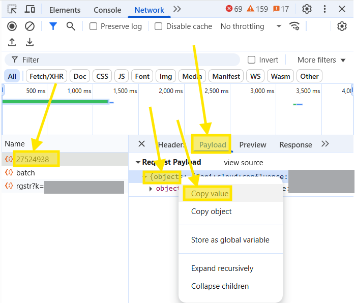

Then go to the Payload tab in the developer tools, right click on the Request Payload and click on "Copy value" as shown in the screenshot below.
This is the "Custom data" rule 1 should send the web request with, so open the rule 1 config and paste it there so that it looks like in the screenshots above for rule 1. Then edit the page ID at the end of the "Custom data" to be "{{cqlResult.id}}" so that it sends the page ID of the respective CQL result instead of the static page ID you just triggered it manually for (see the screenshots for rule 1 above).

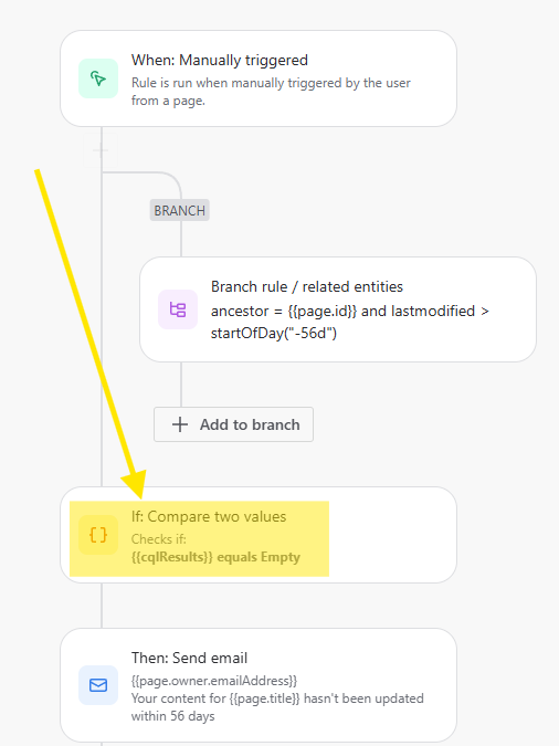

In rule 2, we use the same concept as in rule 1 to trigger a rule 3 and 4 which looks like rule 2 (manually triggered). Example CQL: parent = {{page.id}} and title ~ "Project Landingpage" and lastmodified < startOfDay("-56d")
The key idea here for rule 3 and 4 is that we use "Branch rule / related entities" to run a CQL and if the result is empty (meaning no pages are found which were modified in the given time range), we do some action. To check this, we use the "{{smart values}} condition" as shown in the screenshot below comparing "{{cqlResults}}" to empty (just leaving the second value empty and using "equals" to compare).
