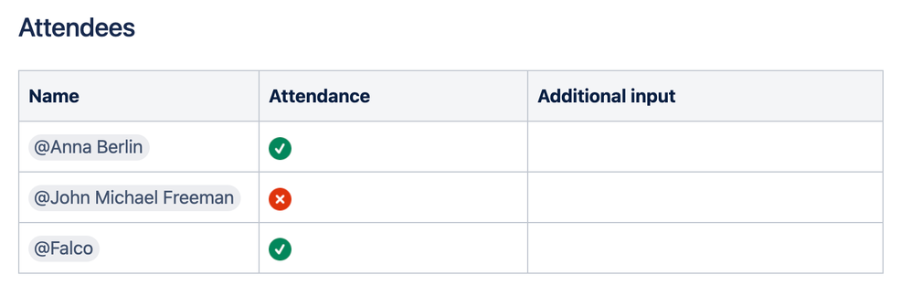

For the attendance list, you could use a table with (/) and (x) symbols to track attendance instead. Or you use a status macro.
