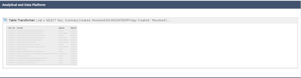

I am extracting the defects from JIRA to confluence page using Macro - Table transformer and inside that another macro - Insert JIRA Link.
I am calculating the number of days taken to resolve and issue, for that I am using the  SQL Query:
Attaching the heading of the table of how it looks on publishing for reference:

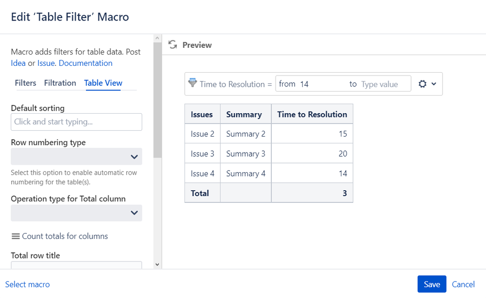

To count the number of tickets with the Time to Resolution more than 14 days, you can with the help of the Table Filter macro:

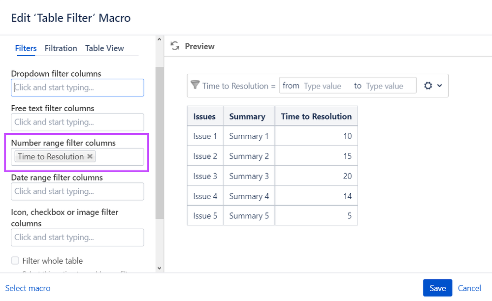

Go to the Table Filter macro settings and set a range filter for the Time of Resolution column:

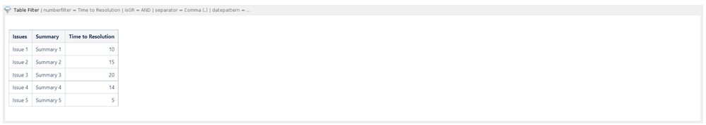

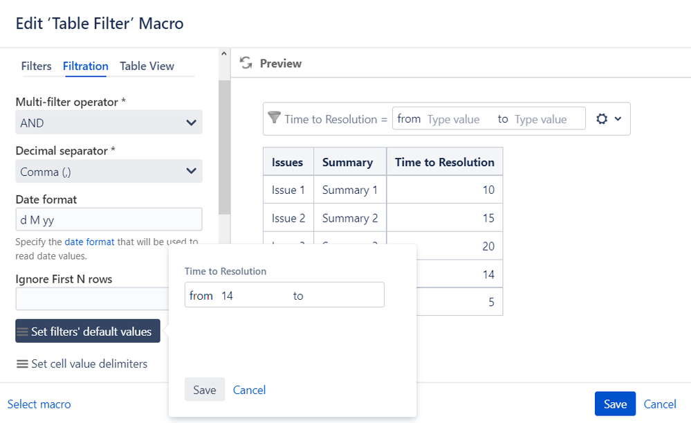

Set the required value:

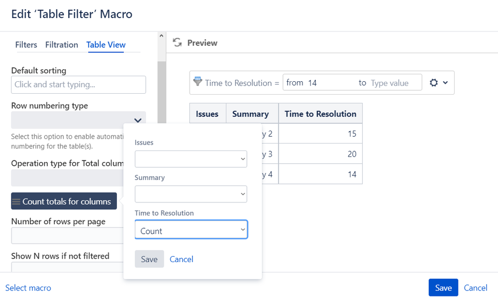

Then calculate the number of the remaining issues:
The filtration panel can be hidden if necessary.
