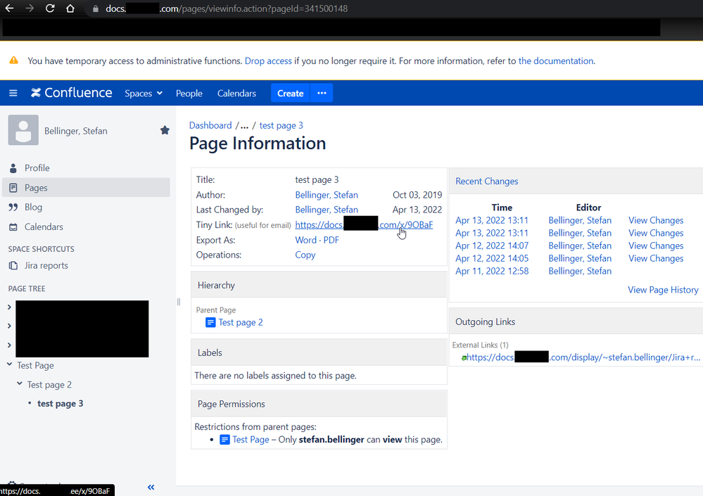

On a side note this issue is occurring in specific sections like page info tiny link and when selecting share. It is not an issue on sections like "Recently worked on".
Below is a Screenshot of an example. Notice in the bottom left it lists .ee instead of .com which is the url listed in the Tiny Link section. I have the same issue with every other space.Page Info Tiny Link.png

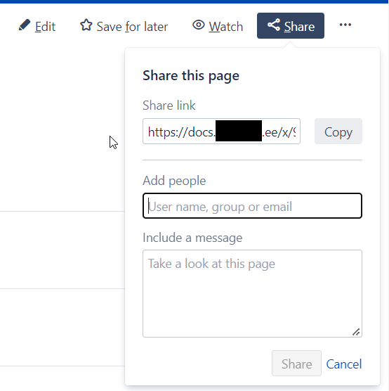

Here is an example of the share link url for the page in the above example.
