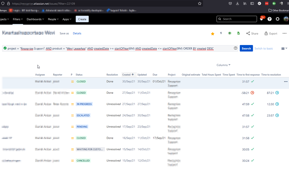

Now i'm experiencing a curious problem. I made a filter in Jira that shows all the necessery colums I want. Including the SLA columns "Time To First Response" and "Time to Resolution.

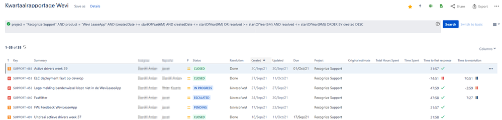

However, when I embed this filter in Confluence it says "not Valid SLA" (The SLA is valid as it shows times and markers in the Jira filter and in the JSM tickets.

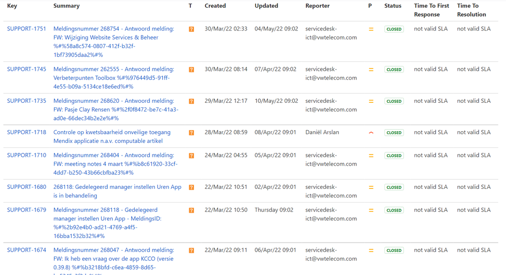

ofcourse:
The list: Note the first ticket, that's a ticket in which we failed to respond as a first response within time.
Also is the filter made up of multiple projects?

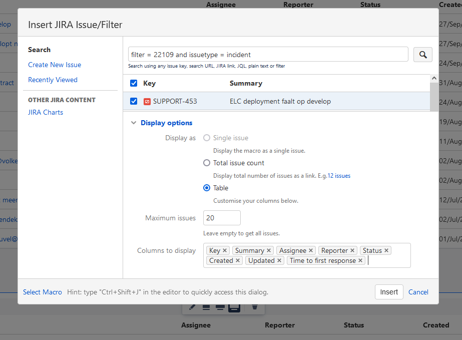

No this is my filter with an example project and product:
project = "Example JSM Project" AND product = "Project example" AND createdDate >= startOfYear(6M) AND createdDate <= startOfYear(9M) ORDER BY created DESC

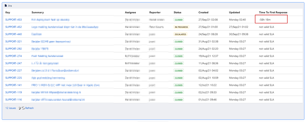

I see i blurred a bit too much. I have a screenshot that shows a couple of ticket numbers.

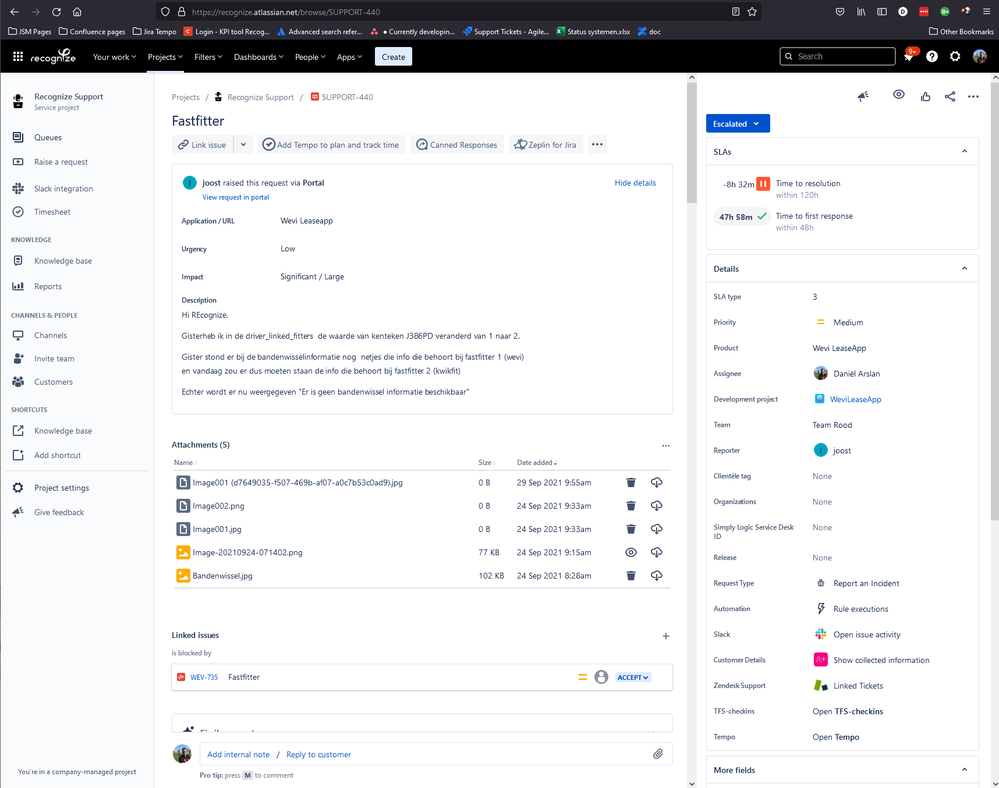

All issues show in the filter, however the field "Time to first response" of ticket numbers (Key) SUPPORT-453 shows the time (The only ticket where we did not manage to have a response-time within the SLA)
Key's SUPPORT-452, SUPPORT-440 and SUPPORT-403 as you can see have a response-time that shows up in the filter but it gives a "not valid SLA" in confluence.
This is a screenshot where you can see a bit more, i keep the names blurred if that is okay.

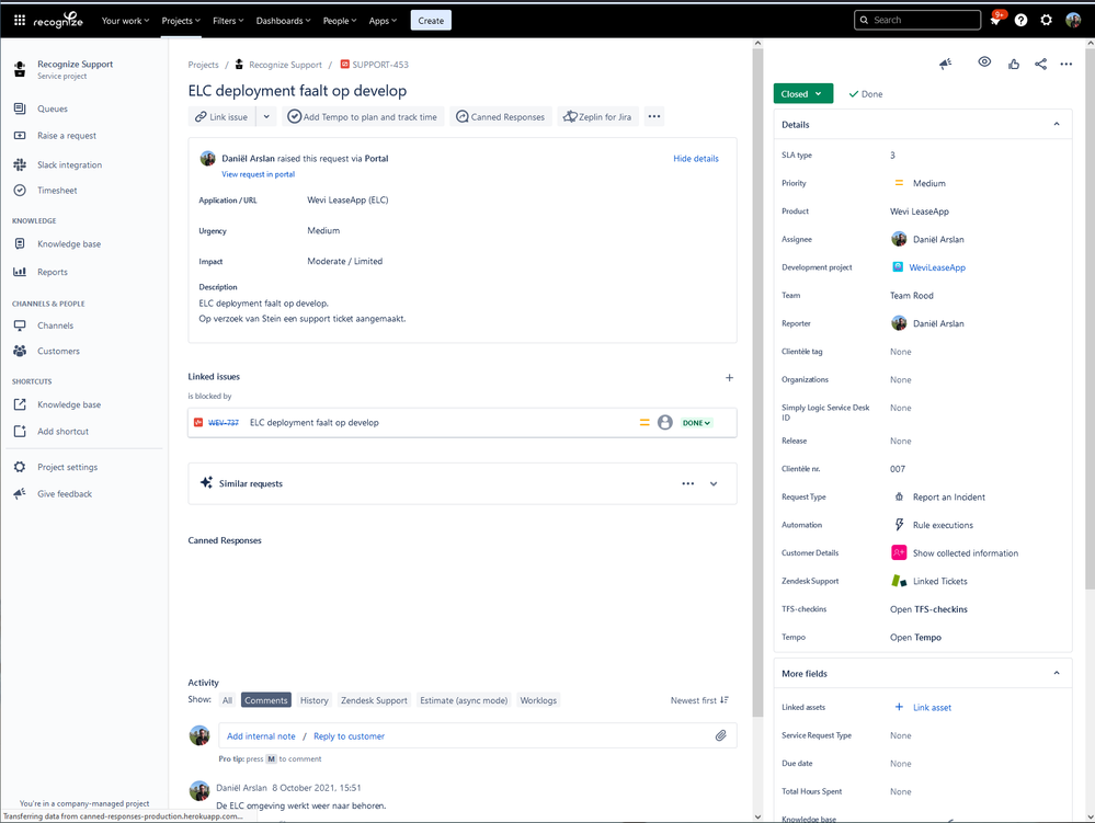

@d.arslan I was just looking at what you provided again and I do not need what I asked for above. I noticed something with what you shared. Support-453 does not have an SAL on the issue yet it shows in Confluence. All the other issues you shared do have responses. I was able to get the not a valid SLA to display when I used an SLA not associated with the issue in that project. Could you check in confluence if there is multiple time to first response?
@Brant Schroeder first my reply on your first question: in screenshot 1 i will show the filter results on 2 it is the jira view in confluence: the orange icon is a task, the red icon an incident and a purple icon a change. out focus on sla's and first responsetimes goes out to incidents.

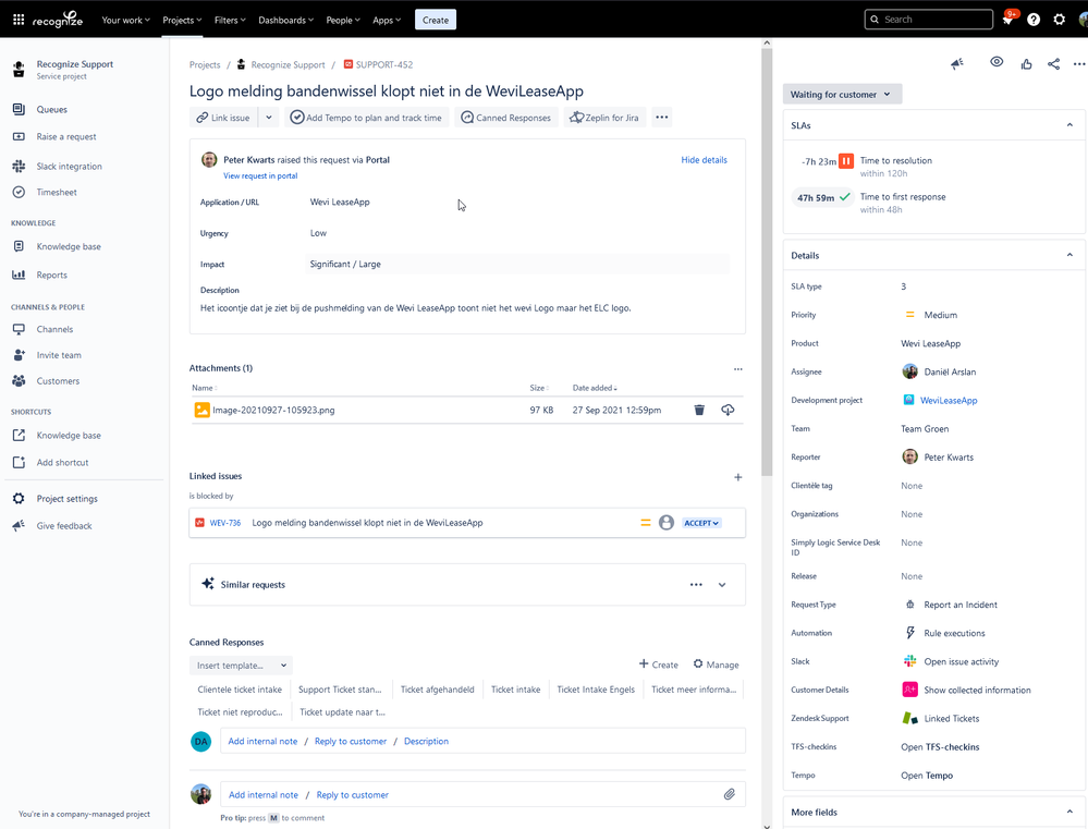

On your second post from yesterday: I was aware on the problem with ticket SUPPORT-453. There is already an issue made on the support site of Jira. Since a couple of days SLA's disappear on the issue-pages. We've already let the Jira atlassian specialists look into it but they can't see either why this happens.

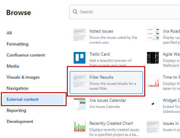

@d.arslan what I meant, the new cloud integration is also working now, that has been patched.
@Magnus SolmyrYou are correct, I've changed the filtering on my Jira tables in confluence so that they show the "Time to first response" column. Everything is showed correctly now. Thank you! Issue is solved.
